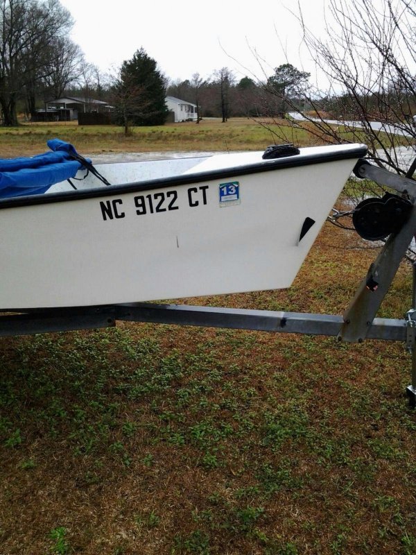

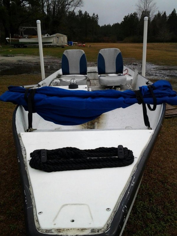

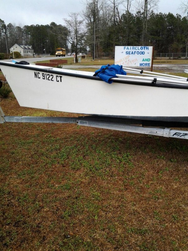

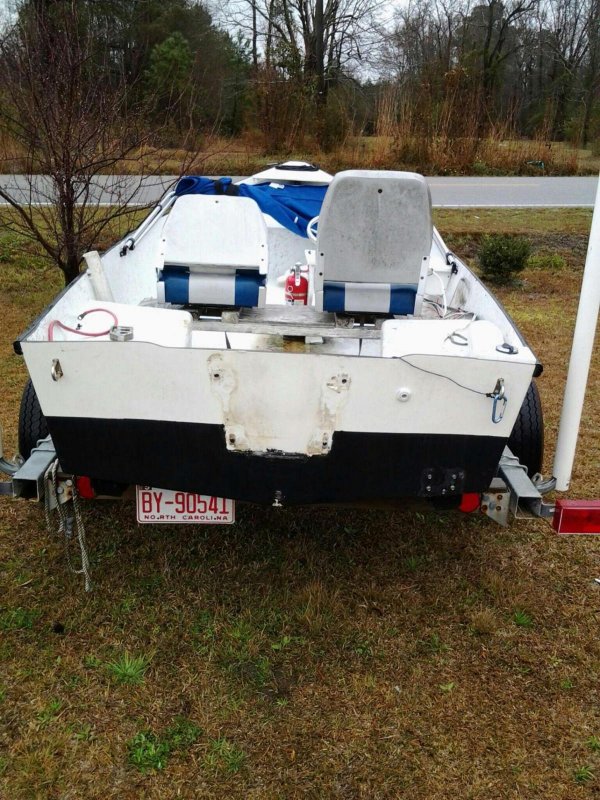

  18. I came accross this boat on Craigslist Wilmington identified as a "Silvia Skiff." I got some more photos and sent them to Graham to review. He agrees that this appears to be a fiberglass Bay River Runner built by the late Nelson Silva. If the bottom paint can be easily removed, I think it would clean up nicely. http://wilmington.craigslist.org/boa/3547684276.html
