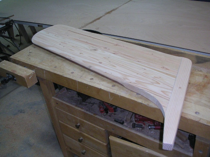

John Turpin Posted August 18, 2009 Author Posted August 18, 2009 I made a little more progress this weekend. I've now got the centerboard glued up and the outside shaped. When I get home from this business trip, I'll start shaping the leading and trailing edges. I'll be working freehand and I'm not exactly sure of the best way to tackle that shaping work. Hand planes? Power hand planer? Belt sander? I may have to just experiment. The board is Doug Fir, so it shouldn't be too hard to work it. Also, my Okoume arrived. I didn't really have a good place to put it, so I built a rack along one wall of my workshop. Now, I can store full sheets and cut pieces a little more safely. Quote
tom151 Posted August 18, 2009 Posted August 18, 2009 I'll be working freehand and I'm not exactly sure of the best way to tackle that shaping work. Hand planes? Power hand planer? Belt sander? I may have to just experiment. The board is Doug Fir, so it shouldn't be too hard to work it. If you have a router... the general technique as shown in the Duckworks article here... http://www.duckworksmagazine.com/09/howto/foils/index.htm should be useful. Many have reported good results with this type jig. There is an alternative to all the math and spreadsheet work if you want a simpler approach - (1) 1st make a full sized pattern of your foil section from 1/4" ply or timber - (2) cut a circle of 1/4" ply with a radius equal to the cut depth you will use with the router - (3) stick a pencil through the hole in the middle of the circle and roll it along the perimeter of your full size pattern. You will now have the exact shape to use to make the router guide side pieces shown in the pictures of the article above. Not my idea and I don't remember where I stole it, but certainly a simple and reliable technique for making router jigs of most any shape - without the math. Hope that helps, TomH Quote
Apteryx Posted August 18, 2009 Posted August 18, 2009 Thanks for that tip! My first attempt at a centerboard turned out quite horrid. Good practice, I guess, but somewhere a fir tree weeps for the sad fate of her children, hacked to pieces and entombed in a centerboard not fit for firewood. Oh, well, thank goodness for the privileges of being warm blooded. Quote
John Turpin Posted August 21, 2009 Author Posted August 21, 2009 I spent much of the day shaping #5's centerboard. While I did rely on templates and paper patterns, the shaping was pretty much done by "feel". I want to spend some more time with it tomorrow, to see how close to symetrical I can get it. I also want to put in some lead shot and a rope leading edge. Quote
