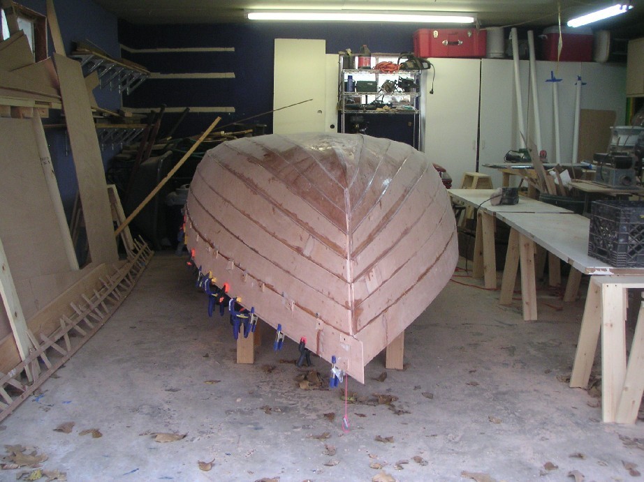

If anyone asked you can say you went 8 rounds (one for each strake) with a Lapwing.  I might hunt out one of those ice hockey goalie masks before I get to that bit.  I am just redoing Strake four.  I assume with your spiling truss you are laying one of the battens sitting on top of the previous strake (overlapping 3/4 inch).  For what I am learning (by eating ply) is that will give you a more realistic shape them just laying a single batten against each bulkhead - but not contacting the edge of the previous strake.

Looking fantastic John.  Have you done much filling of the strake joins (fillets)?    What sort of fibreglassing have you done around the bow?

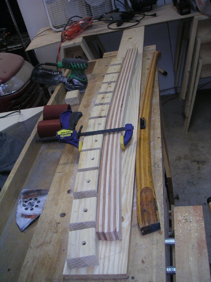

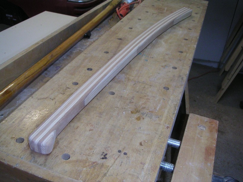

I have had other things going on.  Have No. 5 cut out and ready to go.  Looks like they are going to fit OK.  I have also been cutting some strips to laminate up a tiller.

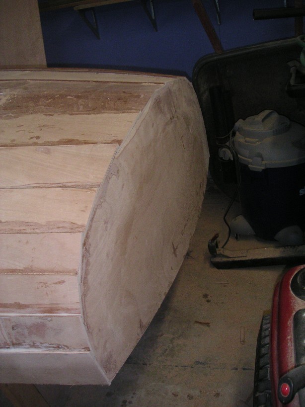

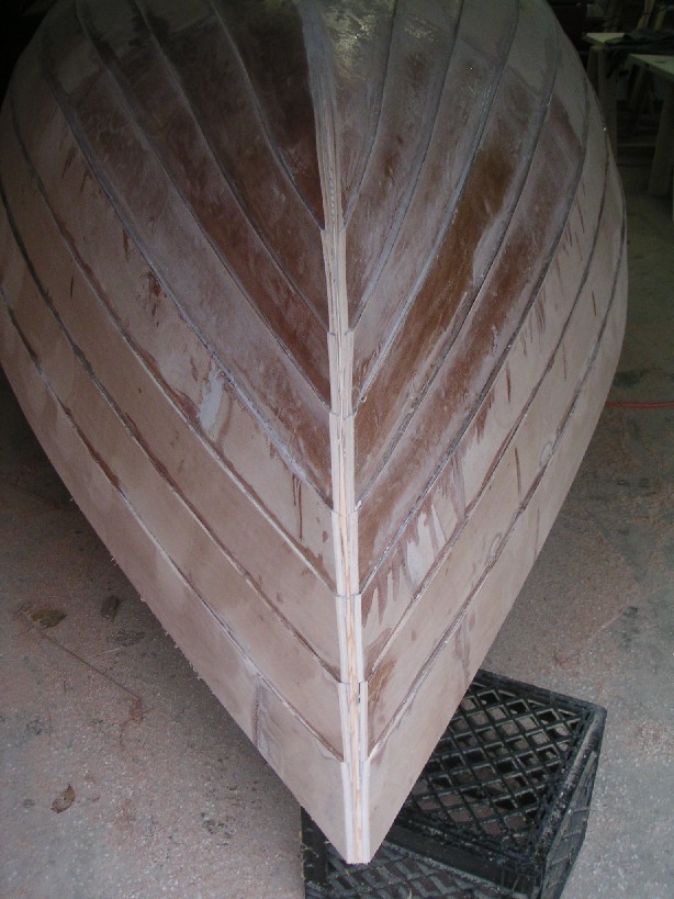

I've done some work on those join fillets, but so far, only on the outside of the hull. It just takes a lot of sanding to prep for them first.  I'm slowly getting there.  Until now, I've been doing it whenever I see a gap. But eventually, every lap joint will have a nice smooth fillet--inside and out.
As for fiberglass, I don't intend to cover the entire bottom. I'm just covering the first couple of feet at the bow on the lower planks. I figure that if I hit a rock or stump some day, it will probably hit there.  Those planks' cloth runs from the stem to that first bulkhead.

I'm traveling again this week, but can't wait to start on that stem/keel when I get home.  And the tiller.  Oh, and also the masts. I started fiberglassing the bearings and shoulders on the mast tubes. A little sanding and they'll fit great.  Then I can start on the birdsmouth mast tops.

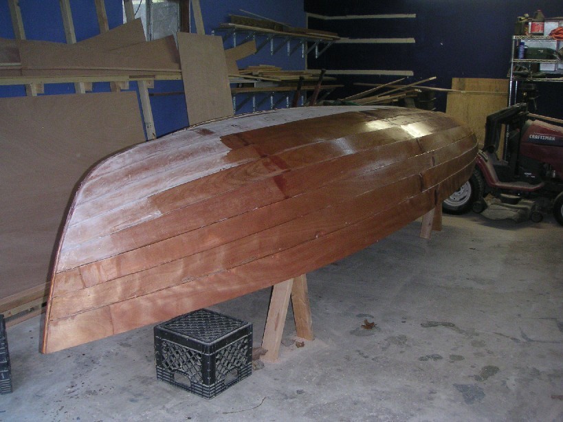

Hull is looking really nice John.  I have just finished strake 6 and starting on 7.
