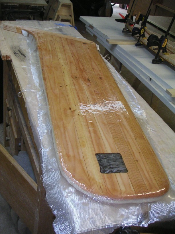

John Turpin Posted August 26, 2009 Author Report Share Posted August 26, 2009 A little song, A little dance, A little centerboard lead, perchance? I bought a big box of lead fishing sinkers and smashed them flat. I then routed out a 3" X 3" pocket in the centerboard's foot. A little epoxy will hold it is place until it's all wrapped in cloth. I didn't weigh it, but it's probably between 2 and 3 pounds of lead. Note: Someone asked me why I chose lead sinkers instead of poured lead. Well, it was kind of the process of elimination. Of course, melting and forming a lead disc/block would have been the best, but I don't have a way to melt lead. So, I planned to use lead shot. But, my local sporting goods store no longer carries reloading supplies. I looked at a big container of BBs, but reading the label, I discovered that BBs are made of steel. The fishing aisle provided me with a huge selection of lead sinkers. Presto! Quote Link to comment Share on other sites More sharing options...

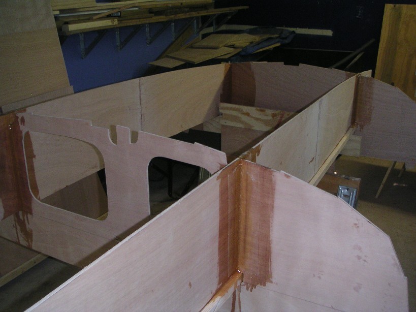

John Turpin Posted August 29, 2009 Author Report Share Posted August 29, 2009 It . . . is . . . alive! Now tell me that doesn't look like a boat. You can't, can you? Quote Link to comment Share on other sites More sharing options...

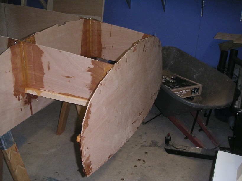

John Turpin Posted August 29, 2009 Author Report Share Posted August 29, 2009 I'm not familiar with the plan design. If not a NACA foil, what is it? I'm not sure. The leading edge looks NACA"ish" and so does the trailing edge, but the center of the board is flat. In a true NACA foil, that arc doesn't really flatten out. I'm no fluid engineer, but it looks pretty efficient to me. Quote Link to comment Share on other sites More sharing options...
Apteryx Posted August 30, 2009 Report Share Posted August 30, 2009 John, that sure does look like a boat, and what a beauty! With that ruler flat bottom she will plane like a WITCH!! Extending the deckhouse all the way aft was a stroke of genius, although that completely curved deck might get slippery. No, wait, I see the stairsteps you've engineered. Brilliant. :drinking: Seriously, congrats on the progress! Someday I'll catch up. Slow but steady, that's me, maybe a little too much emphasis on the 'slow' part, but what wonders I'm learning. Wood is so cool. Lapstrakes, that looks cool, too. :-D Quote Link to comment Share on other sites More sharing options...

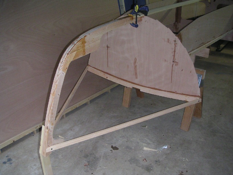

John Turpin Posted September 10, 2009 Author Report Share Posted September 10, 2009 The transom went on. Quote Link to comment Share on other sites More sharing options...

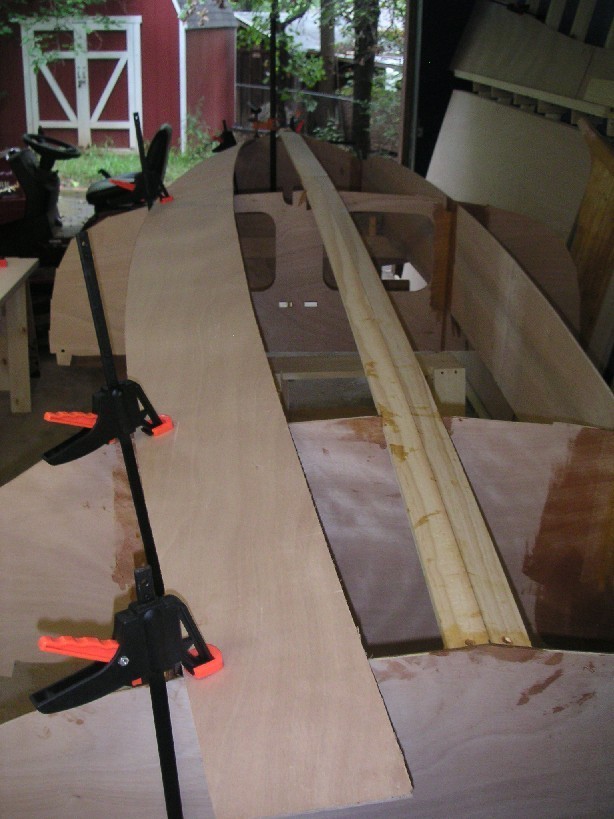

John Turpin Posted September 17, 2009 Author Report Share Posted September 17, 2009 First plank is cut and temporarily clamped in place. Quote Link to comment Share on other sites More sharing options...
Richard Whitney CS#70 Posted September 18, 2009 Report Share Posted September 18, 2009 Thats looking good John. Should be easy to get the shape of the garboard. I have to do some 'creative fitting' of the join between the garboard and 2nd strake at the stem - there is quite a bit of twist in the garboard. In the end it looks fine (unless someone turns the boat over and looks carefully) Quote Link to comment Share on other sites More sharing options...
