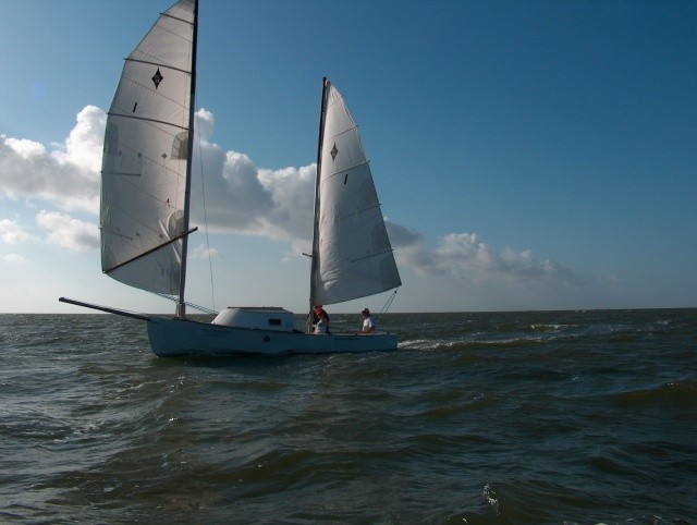

[img
Not square topped by a long shot, but more roach than the straight triangle designs.....like on my Spindrift. Square topped would lop off the top above the top batten. And in Sukie's photo.........
you can see the top of the mast is already bent a little, which I suppose is what more tension to clean up the twist in a square top would get you. But do that right, and you might get a nice shock absorber effect. They say wind surfers do that when they get it dialed in right. But at the length of these masts and that amount of tension, still not sure if it's even possible.....or if the performance gain is worth it.
Graham....is the problem with the top batten on a square top limited to getting it off the mast to lower the mast, or does that also include simply dropping the sail to stow it? Like a dorsal fin that won't go down? That would be a real pain on a cruising boat.
I guess to cut to the chase I should simply ask.......ya think some version of a square top could be used on a Princess? And I'll be the first to admit there is a difference between "could be" and "should be". Could doesn't mean you should!  ;D
