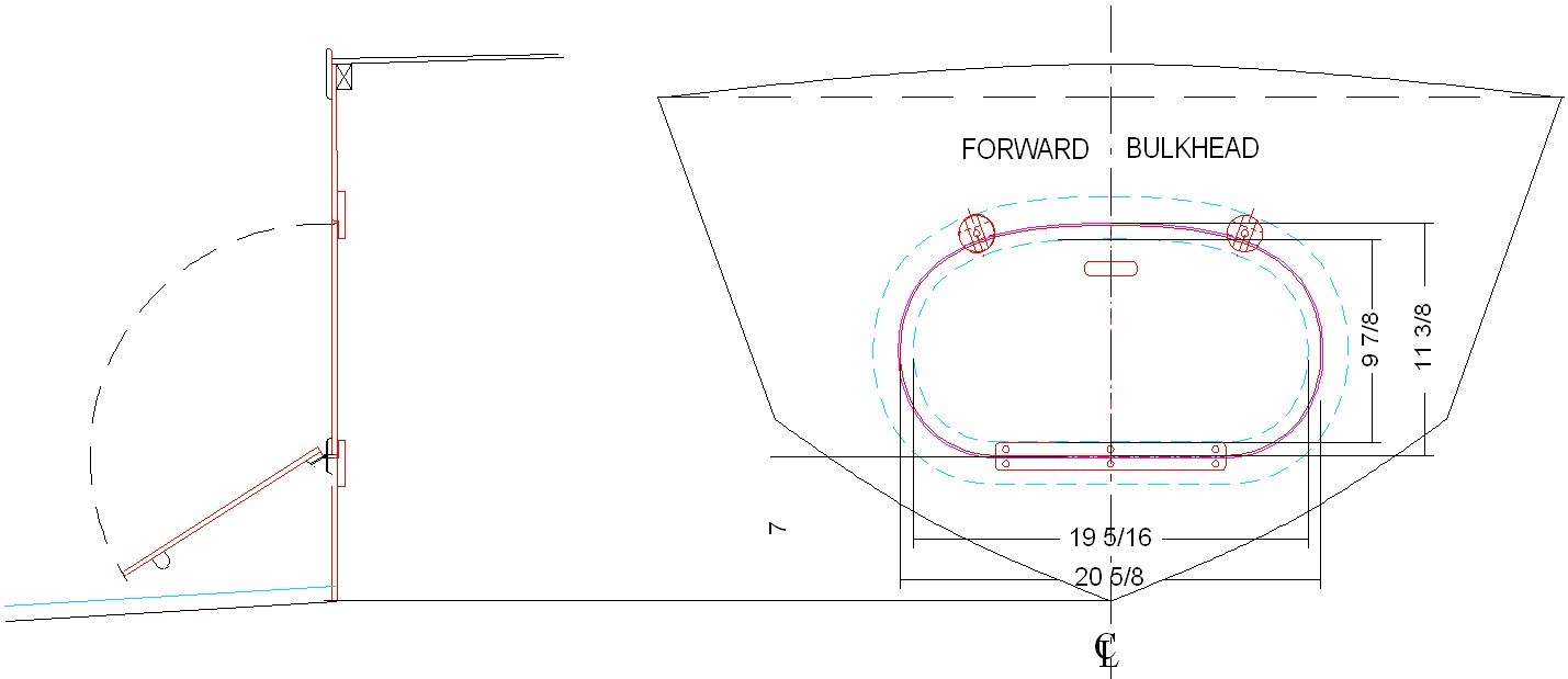

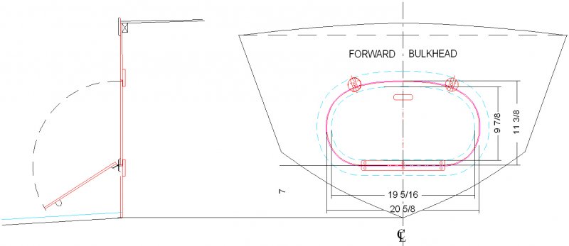

Guest Dennis M Posted August 22, 2008 Posted August 22, 2008 Here is the drawing of the hatch that Graham sent me and I used for the fwd bulkhead. Since we are on the subject of hatches, what gasket material would one use? Also, what would one recommend to use as latches? Thanks, Dennis. Quote

Charlie Jones Posted August 22, 2008 Posted August 22, 2008 Dennis- at ACE Hardware we found some 1/2 inch sticky back foam tape- (harder stuff-NOT the soft foam) that we used inside the hatches on our 25 footer. Worked very well. That type thing should do quite well to seal that hatch. Remember though- you'll have to allow for it's thickness when you do the flange. Also- from the drawing it looks like the latches are the standard metal twist type turn buttons. You can buy them in many marine outlets. One is shown on page 560 of the 2007 WEST Marine catalog, called a "door button" Graham may even be able to supply them- check with Carla. You could also just make wooden turn buttons that would do the same thing. Quote
