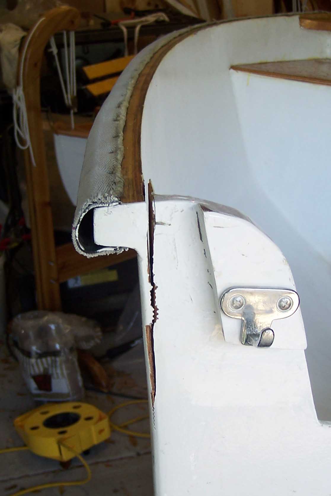

Steve Day Posted May 29, 2008 Report Share Posted May 29, 2008 Hey folks! We were out this past weekend in Big Lagoon (just west of Pensacola Inlet) with the big boat, the Hobie cat, and my Spindrift. We had a great weekend and it was quite uneventful, except for one incident. As usual, there were hundreds of power boats churning up the waters running from one end of the lagoon toward the other and back again. > They give no thought at all to the wakes they are kicking up when they do that. Normally, when we are at anchor with the Beneteau, the wakes are not a problem. However, when we are rigging the Hobie or the Spindrift for sailing, it does get a bit interesting. ;D We thought we had a lull in the wakes when I was de-rigging the Spindrift and I was on the little boat getting ready to take the mast off when a wake hit and I lost my balance. I fell onto the gunwhale just forward of the nesting joint on the port side and started shipping water, so I rolled off the boat and into the water. :-[ I didn't notice it then, but as I got out of the water onto the big boat, I saw the crack in the hull on the Spindrift. We made a couple of final trips to the beach with the motor and hoisted the nesting halves aboard the big boat for the trip home. Here are some pics of the damage taken this morning in the garage. I'm thinking that I will epoxy this back together and then reinforce with fiberglass tape. IMHO this is not a design/construction flaw as the load of a 225+ pound guy hitting the gunwhale in this manner could not have been anticipated as a normal load for the boat. Steve Quote Link to comment Share on other sites More sharing options...

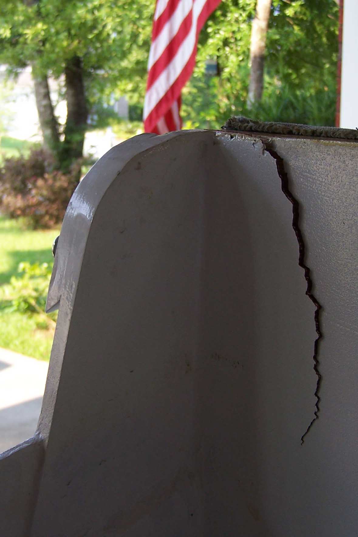

Joe Nelson CS#35 Posted May 29, 2008 Report Share Posted May 29, 2008 I've been thinking that a lot of you have been using too small of fillets. It appears to me that a larger fillet in the corner may have prevented this failure at the joint. Looks like a lot of people use their popcycle sticks to make fillets. I made sticks out of plywood and made them to the size that Devlin specifies in his book. It takes more material and adds a bit of weight, but remember that we are substituting wood and nails with fillets and fiberglass. I also add 1/4" fiberglass fibers to fillets and glue joints in areas of high stress to add strength. It is like adding fibermesh to concrete. Especailly useful in areas like the transom for powerboats. Quote Link to comment Share on other sites More sharing options...
PinoyPiper Posted May 29, 2008 Report Share Posted May 29, 2008 ouch! did you tape the outside joint? Quote Link to comment Share on other sites More sharing options...
wkisting Posted May 29, 2008 Report Share Posted May 29, 2008 Well, if I understand the pics correctly, fillet size looks irrelevant in this case. It seems as though the plywood split along/between the plies (delaminated by the force) while the face ply (making contact with the fillet) held firm. The only thing that might've stopped it from cracking this way is tape on the outside of the joint. (I'm assuming it wasn't taped, as it seems strange that a taped joint would split like that... though not impossible.) I agree it's not a design flaw. Hope you weren't bruised too badly, as it looks like you must've hit it hard. But I think your plan of repair will be fine. When you slather epoxy in the gap, be careful not to overclamp it or you might starve the repair. It will be better to leave the ply *slightly* out of fair for the sake of the glue, and then sand the surface back to flat once cured. Quote Link to comment Share on other sites More sharing options...
Tom Lathrop Posted May 29, 2008 Report Share Posted May 29, 2008 I'm in agreement with Wes. The failure in the plywood is in the center of the vertical grain ply for most of the split length. A better outside fiberglass reinforcement along with a decent knee at the transom/sheer joint would be the best preventive measure. Doesn't Graham call for a knee there? On a second look, I see that this is at the nesting joint and no knee is called for there. If you are going to continue falling on it, you might consider a small corner knee for reinforcement ;D ;D Quote Link to comment Share on other sites More sharing options...
Steve Day Posted May 29, 2008 Author Report Share Posted May 29, 2008 Gang, It is not my intention to continue to fall on the gunwhale! I hit on my hind parts, so it didn't hurt me (lots of padding back there), but I don't want to do that again. I should have had video of the incident and put it on U-Tube. The outside of the joint was taped, but the force of the impact just ripped the tape. The failure was definitly in the 6mm plywood. From my size and the direction of the impact, I would have been surprised if it had not broken. BTW, the fillet and the tape on the inside of the joint are totally undisturbed. If you note the pictures, the "tear" surfaced outside of the interior tape. I soaked the broken portion in epoxy and have clamped it in place, squeezing out some of the epoxy, but not all. After that cures, I intend to add tape (or cloth) to reinforce the joint. My bet is that you will not be able to tell the repair is there after I get through with it. Ain't life Grand?? Steve Quote Link to comment Share on other sites More sharing options...

Steve Day Posted May 30, 2008 Author Report Share Posted May 30, 2008 Mike, The fix has already been accomplished. I have the "tear" epoxied together and reinforcing tape epoxied over both sides of the repair. All that remains is to fair in the tape and put the final finish on it. Pictures will be sent in the next day or so. As to the unintended swim, my only problem was swimming with the jellyfish. Fortunately, they and I did not cross paths while I was in the water. I'll still take the lightweight "Stitch and Glue" construction over traditional. Particularly when we are hoisting the boat aboard to store it on deck. ;D ;D Have a good one, Steve Quote Link to comment Share on other sites More sharing options...

Greg Luckett Posted May 30, 2008 Report Share Posted May 30, 2008 Steve, glad you were not hurt and the boat damage seems minimal and an easy fix. I am thinking that a small knee might have made a difference, but who knows? I do like to beef up the transom and any bulkheads or any place my large, padded body, might fall or walk on. I often tape joints even when the design does not call for it, or use larger dimensional lumber, especially in what will be hidden areas. I learned that one from my father's boat building experiments back in the 60s. I take it that neither you nor Oyster will be at the 2008 Texas 200 or the Duckwork Mess About? Quote Link to comment Share on other sites More sharing options...
