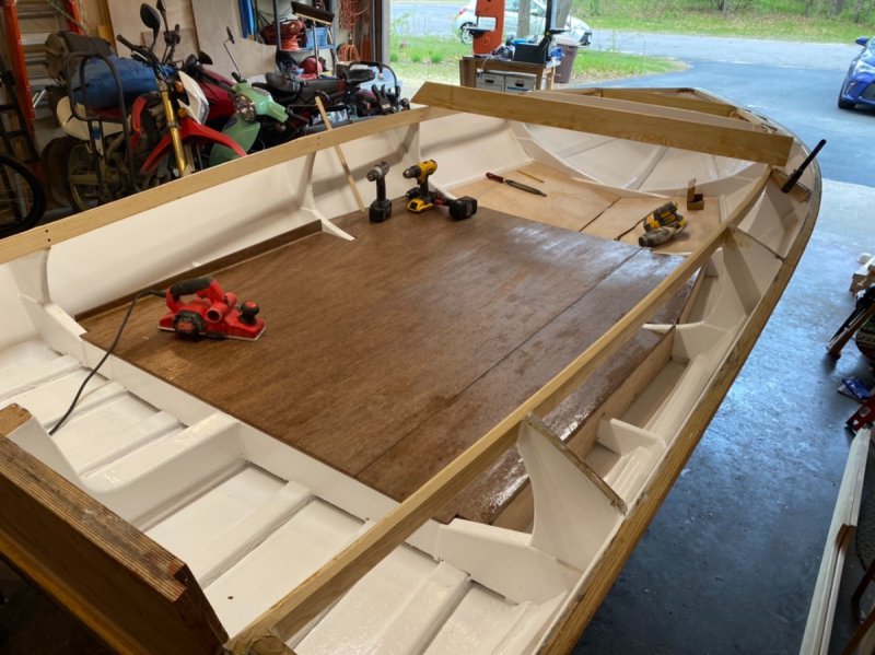

Since my last post, I installed Joe’s carlings. Both bending and twisting of the 10 foot 3 inch boards was needed to get them close to where they are supposed to be... some significant force was applied... so much that I pulled out a couple screws from two frames.  After some verbal expressions — during which my wife and son who were helping me kinda quietly backed out of the garage leaving me to figure things out  — I made up some more thickened epoxy and clamped a few backing blocks in place to fix things. It came out fine.

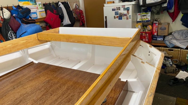

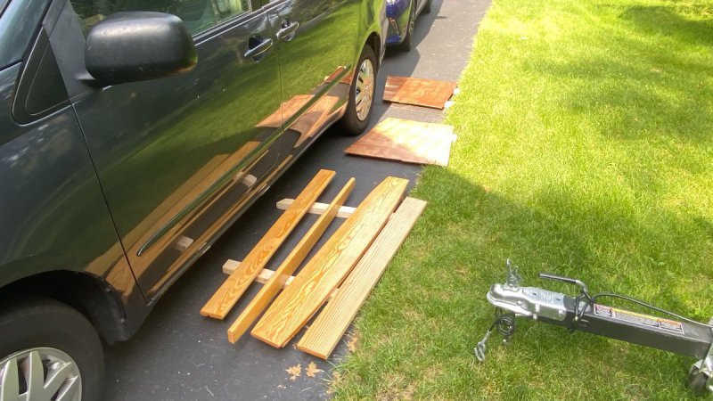

I also cut out, fit, and rounded the edges on two 10 foot pieces of nice southern yellow pine (that I got from B&B Yachts). These coaming pieces will be varnished and will be a significant amount of bright wood.  Installation will come a ways down the line.
Today. I faired the carlings to begin fitting the side decks, which need to be installed before I put in the coamings and begin transom work.  To install the curved sawn battens for under the deck plywood in the bow I needed to install 10 small blocking pieces to the frames, such as this these blocks which will back up the side deck’s butt joint.

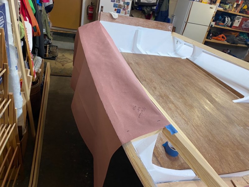

All of yesterday’s new pieces are planed and shaped to receive the side decks so four paper templates were made.  Rain fell most of the day and prevented me from cutting out the pieces.
Marking the fold over the edges works great. (This photo will only load sideways.)
Four templates are set for tomorrow.

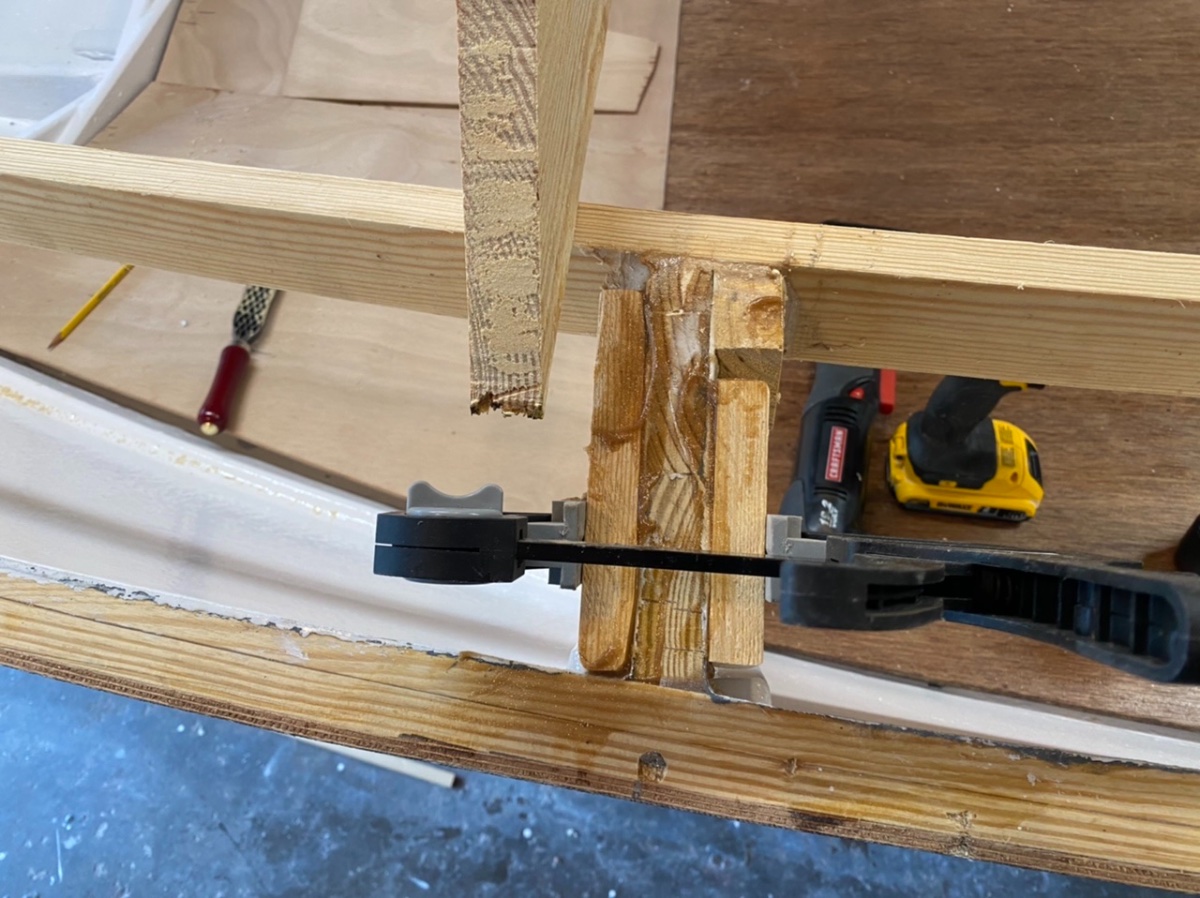

THEN, when fitting a couple side battens for under the side decking... for some reason that I cannot think of, I cut what I thought was the line I marked for the batten length.  Yes, it was one of those “What did I just do?  Well, THAT was dumb!” things.
So I fixed it :

I finished prepping the coamings for installation, rounding the edges and cutting rabbets to receive the side decking.  I also shaved the inside curves of the side deck pieces but won’t install them until after the coamings and controls are installed.  (I marked the outside curve onto each side deck piece and will trim them down tomorrow.)

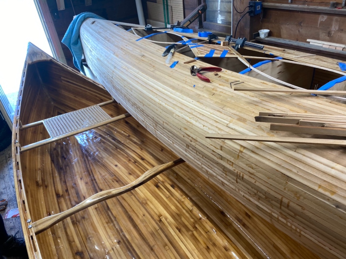

And, I took some photos of my son’s cedar-strip canoe build yet in progress. (The shop is a little tight with his second canoe in there... he removes it out the door to work.). He started filling in the two-fish design on the canoe’s bottom. (Yes, he’s still eating his ice cream cone. )
He taught himself how to make hand-caned seats and carve a carrying yoke  in his last build.

Of the stack of 8” x 16’ clear southern yellow pine boards that I bought from B&B (secured to the top of my van)…
this is what I have left that won’t be used.  I hit it pretty darn close.
The boat’s frames were made from Lowe’s pressure treated 5/4 southern yellow pine decks boards.
