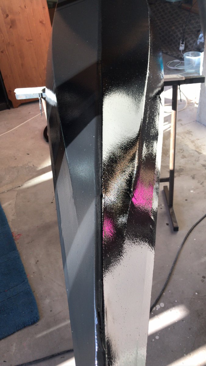

my english is a bit rusty, I hope my explanation is understandable
i have used orange fabric:1.thumb.jpg.9aa028845bc77086de24d98d19f580f9.jpg
applied transparent coating:
applied adhesive letters:
applied black coating:
remove adhesive letters: The "M" is already removed, the "o" is not yet ...
other side: "M" isn´t removed, "o" and "r" are already done, the "o" needs some cleaning. I have used cotton swab and paint thinner
ready:
finaly applied a new layer of transparent coating:
