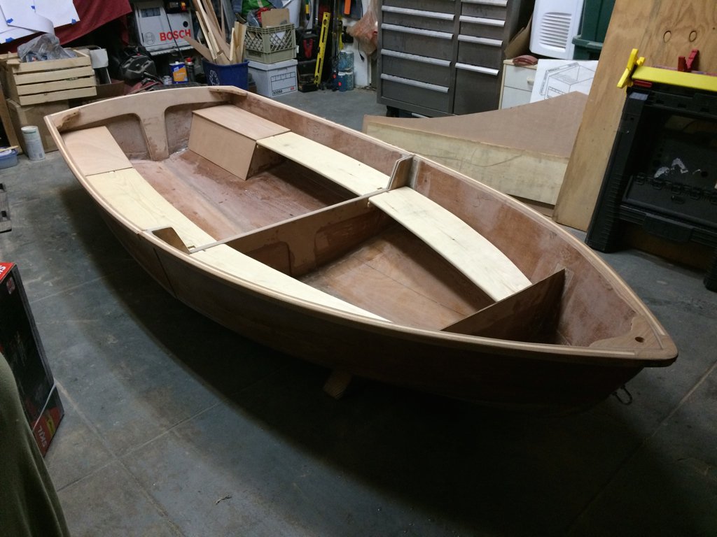

  22. These are some of the photos I took during the build process. I slightly modified the design of the flotation chambers and benches to be more symmetrical and have a more sweeping line from fore to aft. I also designed a bracket to mount the benches that both hold them in place and allows for a line to tie them in place. Like I was saying before, I plan on replacing the forward benches with flotation chambers identical in design to the aft bench/chambers to bring up the side flotation level when it's capsized. It'll be a lot closer to the non-nesting version which has flotation along both sides of the hull. The idea of removable bench in the forward section is nice, and it makes stowing all the parts easier, but I want an easier capsize recovery. I also slightly modified the design of the rowing bench and made it just the right size to stow in the stern while sailing or motoring. It's held in place by two small wooden nubs in the stern, and by the same cord that holds it in place when it's in the rowing position. It's very convenient and pretty much assures that I'll bring it along every time.
