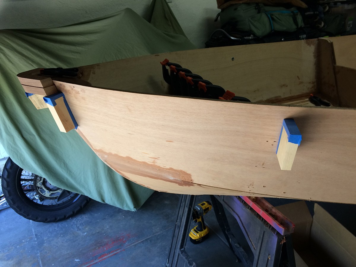

  6. Updates: I cut the boat in half the other day. It was a fun job and it all went well. I used foam core to help design the floatation chambers. These are a little on the small side, but I'll test the boat fully swamped and if I need to I can either expand these or I can build out chambers in the bow. The benches are different than I have seen on a nesting Spindrift so far. I really want this boat to be more sailing oriented, so the benches are on the side and will allow hiking out. I hadn't really seen a great way to attach removable seats, so I designed a way that I hope will work. I made a support bracket with a stop in the middle and a corresponding notch in the bench. I'll drill holes in each bench and run a loop of shock cord that will fit over the ends of the support bracket. It's pretty simple but of course it took a while to make 8 of these and also notch out the benches. I like the result though! I spent some time shaping the mahogany bow and stern trim pieces. I really love the look of the wood, and it's such a treat to work with. I can't wait to see the brightwork all varnished. And the first hardware went on today as well. Our yacht club has a hoist to get boats in and out of the water, so I have padeyes to clip to. Here it is as of this evening. I haven't glued everything in yet, so some parts are rough fit for now. Up next: nesting mechanism, rudder, and tiller.
