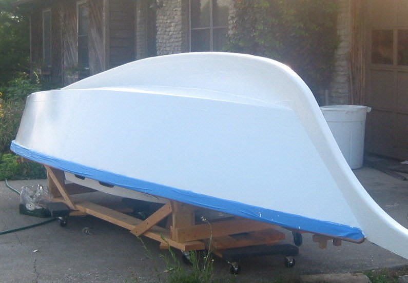

  1. Well,while dodging high nineties heat and humidity, Charlie Girl II progresses. Here she is with her first finish coat on. Gloss white rustoleum over two base coats of primer. Hopefully another coat later today. Scheduled for a deep green sheerstripe. The blue is that marvelous new painter's tape. Great stuff. Working on rudder, motor, and mast construction planning simultaneously. On another front, finding a trailer I can afford is proving to be a rather more difficult proposition than I thought. DocA
  2. Rain the face -- good. Rain on the wet paint -- bad. :cry: Doc(who has no good covered work area for painting)A

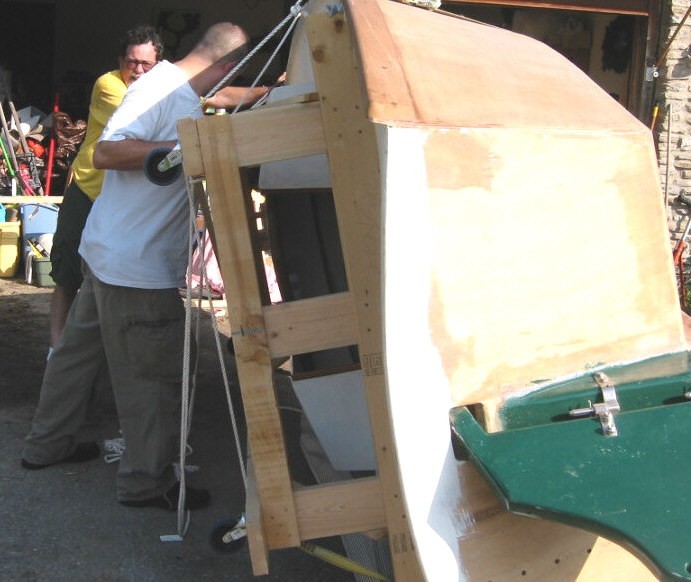

  25. Another milestone. Charlie Girl II went bottoms up, intentionally, this weekend. Absent the ability to assemble a large crew, I decided to roll her over with her new cradle in place. The cradle, massively over engineered except in one detail, was set in place and strapped down. The front cross member has a small stub that fits into the mast well. The stern cross member fits into the cockpit right behind my truncated spash coamings. My strong son hauled the roll-over lines on the up-hill side and my better half and I handled the control line, and over she went. Rub rail / toe rail landed on the prepositioned mattress and, with some sweat and nervousness, over she went. It almost worked. The cradle worked perfectly, but the stern caster wheel on the pivot side blew out. I ended up putting the whole rig back up on the moving dollies I've been using. That was a bit of a disappointment. She is still awkward to push around in and out of the garage. Now, on to sanding and deciding exactly how much time and expense to invest in glassing. Cheers DocA
