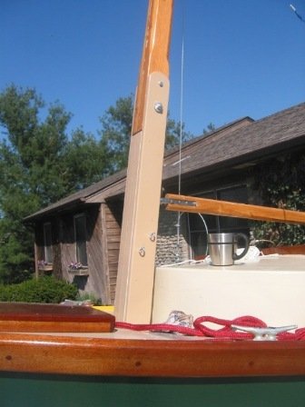

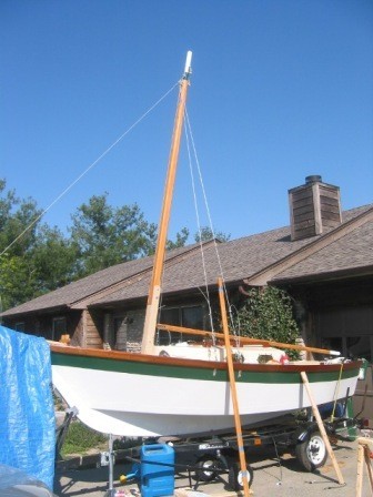

  6. What fun! Ran the mast up to fit the shrouds for the first time today. Tabernacle and extended hatch work fine. I can do everything except clip or unclip the forestay standing steady on the cabin sole; no climbing or balancing. The mast rake seems to put just enough pressure on the locking pin (at least while on the trailer) to make it bind pretty badly. I think I can solve that though. Topping lift was not rigged for this photo, so main boom is just sort of drooping there. Now that I have seen the shrouds, I'm not sure that my plan to eliminate the gaff jaws in favor of a simple crossing boom -- standing lug style -- is going to work out. Not sure about that yet. That's the gaff standing against the port side in the photo. Also will really need a substantial boom and mast crutch rig for trailering. Already working on that. But the tablernacle rig seems much stronger than the hinge thing. Plus I can demount the mast quicly for storage or even to run her as a picnic cruiser under power on the rivers around here. And there is a silver coin under the mast. The goal now is Rend Lake. Lots of details to do, but I can smell the breze. Hey, Adla -- having established yourself as the inspriation for the whole board this spring (both sailing and accurately rating the relative motivational value of grinding academic papers compared to sailing. I'm supposed to present one in late May; haven't even gotten started.) -- any pictures from today? You said you were going sailing. Hope that happened. DocA in the spring time in Kentucky. ps. The tabernacle is really a kind of buff. It looks pink in the photos. It isn't

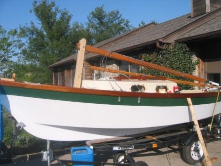

  14. Well, a little bit of break in the weather and a little bit of progress. Mast conversion from hinge to full tabernacle underway and trailer getting done. Got the eyebolt hole drilled in the bow, but still have to stuff it with epoxy. I have an interesting problem developing with the bowsprit, which is suffering a major delamination. I'm going to have to scape the split out, fill it with epoxy or bondo or something and refinish. Bummer. I;m going to try to get that done and the mast rigged this weekend. Color is a bit off; the topsides are actually a pale buff Cheers DocA

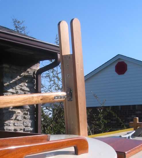

    Longer clevis pin...longer clevis pin... Duh. What did I do with all that industrial design education...so many years ago... :roll: That certainly would have been easier that all that chisle inletting... Anyway, the Duckworks gooseneck is a nice piece. DocA

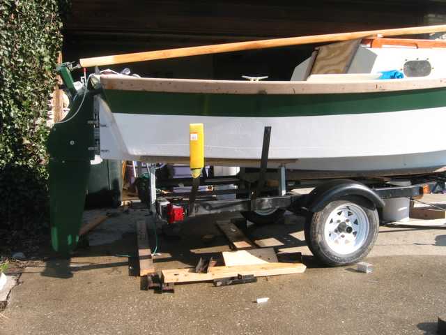

  23. Recap Adla; wow. What great pics. When did you actually study for those mid-terms... :wink: Are those shroud socks copyrighted? They are so classy. Joe on the Hudson: What's that neat catboat? lbrewer. That's so cool, but you obviously live somewhere where it is too warm if those are current photos of the dingy. No fair. As to here and Charlie Girl II; I'll get a couple of pics up, but I have recut the mast base and fitted tabernacle cheeks and have the main boom and gooseneck on now; although some finish and hardware to go. Rudder is rigged. I may try to get the pivot bolt and the lock pin set up this weekend and see about raising the mast once for a dry fit before I take everything apart for doing the finish work on the revised base and tabernacle. Just about ready to start cutting sails. Took some finish damage over the winter; need to do some sanding and refreshing; but with the mast base and boom fitted, now I have tent style cover that sheds water a lot better. Cheers. DocA
