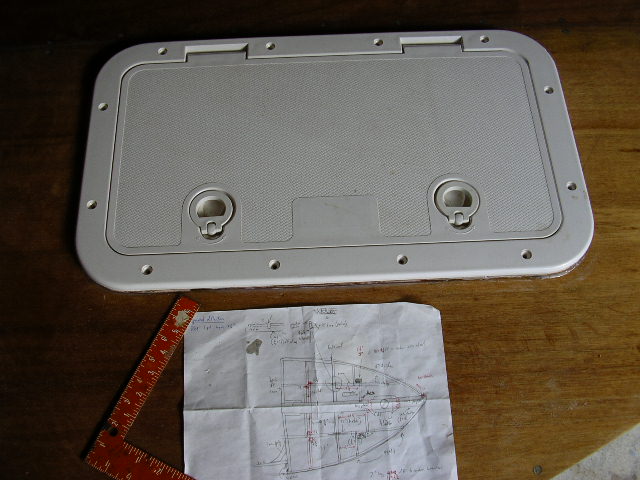

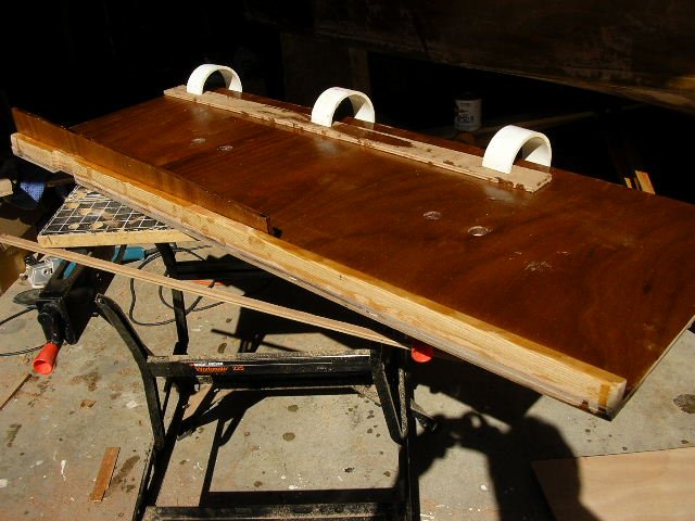

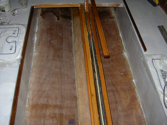

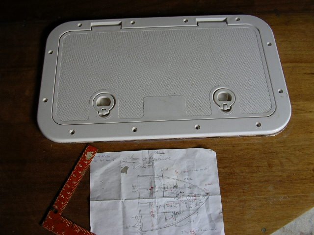

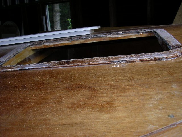

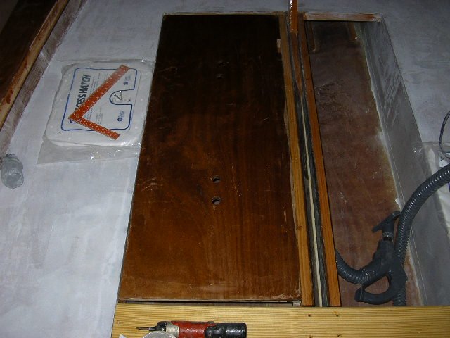

  24. Think I've finally figured out how to set my camera to a low enough resolution! Unfortunately, all my earlier pictures are too big to post, and I'd rather be building than fooling with software. Pictured are my solutions to two problems: the bunk/floorboard business, and mounting a flat hatch on a curved deck. Here goes nothing...
