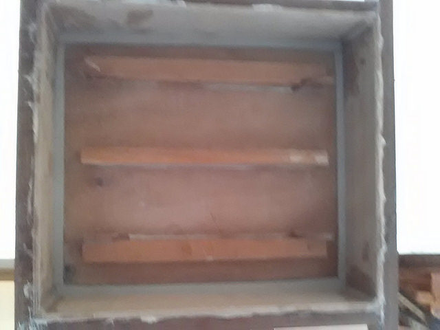

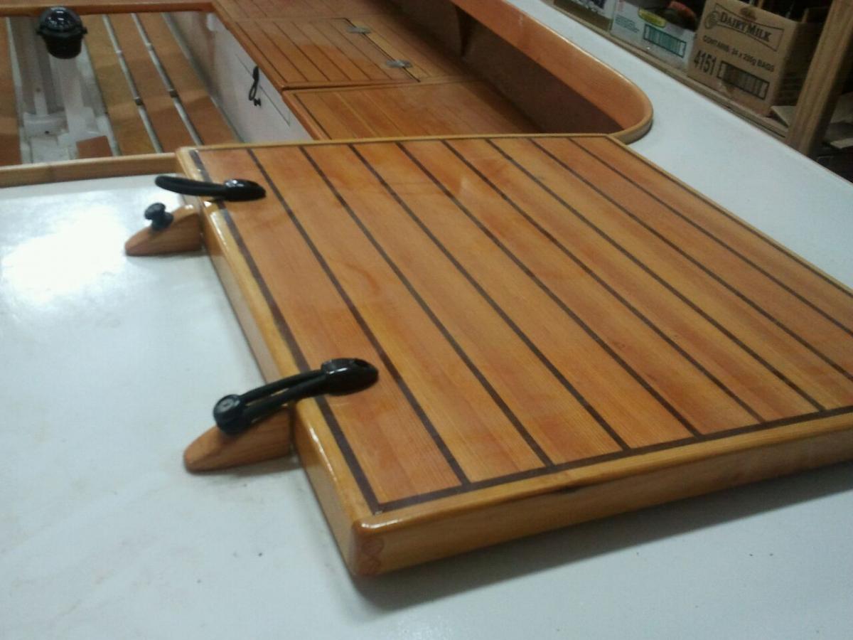

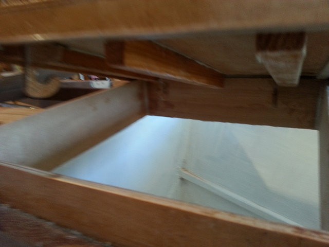

Hi
I am building a Core Sound 20 and the attached photos show my solution which was cheap, effective and does not detract too much from the traditional look of the rest of the boat. The only drawback is that it was a bit fiddly to build. Except for the little ramps (which are essential to pull the cover downwards), all the bits and pieces are carried by every half-decent chandler. Hope this helps.
Howard
Good idea Howard. I prefer hidden latch systems and hinges that can't foul lines, if one is dragged across the top of the hatch.
