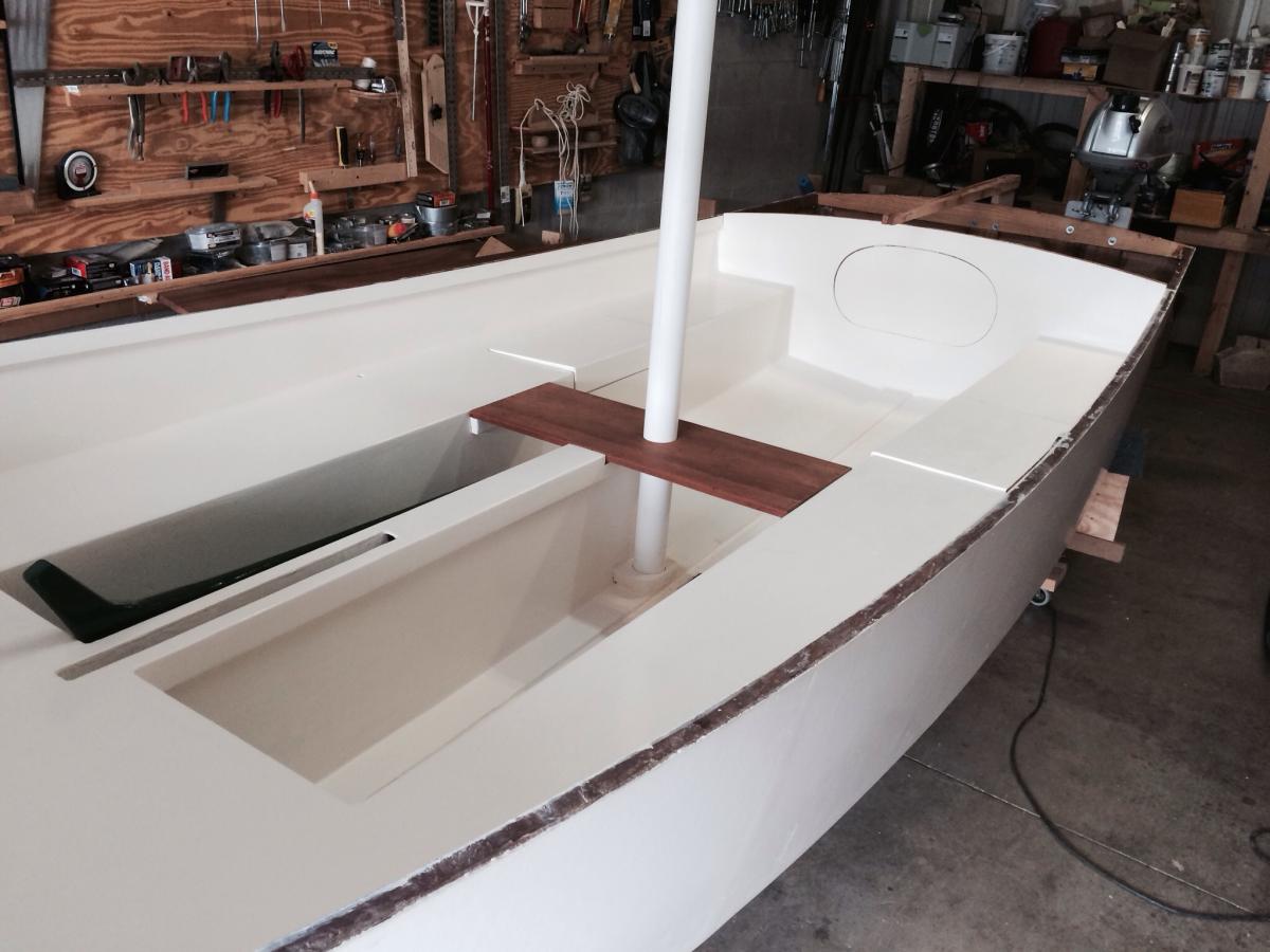

Chick Ludwig Posted September 23, 2014 Posted September 23, 2014 I've tried a new paint and think the problem has to do with a reaction to the epoxy it is applied over. I know that there can be problems with some varnish. I rolled and tipped the paint. The rep said that it would be a good way to apply the paint. It was applied directly over the B and B epoxy coating that was sanded prior to application. Actually, here were three problems. 1. The paint didn't flow out and level. Every brush mark showed. The brush "dragged", even after reducing the paint. 2. The paint was dull-not gloss. 3. It remained tacky (I pressed my finger against the surface and fingerprint remained. It felt slightly tacky.) ---even after three days. It should have been tack free in about 4 hours. I reduced the paint with mineral spirits per instructions. The paint is Sherwin Williams Pro Industrial Urethane Alkyd Enamel. After the weekend I applied another coat reducing with Flood Penetrol. That seemed to work right, but it was over the previous surface that was full of brush marks, so it was hard to tell how well it leveled, but it did dry hard and with gloss. Any thoughts? Quote

PAR Posted September 23, 2014 Posted September 23, 2014 This is a problem with some alkyds and you can't tell which ones it will occur on, so the general recommendation with oil based paints is to prime, preferably with an epoxy. It seems counter intuitive that you'd prime with the same stuff (epoxy) as what causes the problem, but there's a difference between epoxy primer and straight epoxy used as a coating. Something with the alkyd vehicle compatibility with the glycol groups in the epoxy causes this. Sometimes you can wait and it will eventually cure, but other times it just never does or does so pretty soft and again, you can never tell which brand might react. I've seen enough of this over the years, that maybe a list of the known alkyds should be drawn up, so folks can avoid using them or know to use primer. I see less of this with acrylic urethanes and have never seen it with LPU's or acrylics, but it's not uncommon with alkyds. Quote

Designer Posted September 25, 2014 Posted September 25, 2014 I just do not use one part paint on epoxy. I understand the various reasons for doing so. As has been mentioned, uncured amines on the epoxy surface will prevent one part paints from curing properly. Here is what you should. After proper prep, paint a small section of the boat that will be easy to remove if there is an issue, a square foot is plenty. Paint a square foot on a nice clean surface that has no epoxy. This is your control. If both cure at the same rate, then you should be okay. If the control has cured and your painted epoxy is still soft, then you get to clean off a small area instead of big miserable job. Do not be fooled, the paint surface may have skinned over but under the skin is still soft. As has been said, priming first is best for a good finish. If you use a one part primer, do the test, it may save you a lot of work. Quote

Chick Ludwig Posted September 28, 2014 Author Posted September 28, 2014 I tend to agree with par. After turning Turtler over, my resolve to strip and repaint is fading away. She don't look too bad from a few feet away, and she'll get plenty of abuse out on the lake. Speaking of adding an abrasion strip---where is a good source for hollow back, 3/8" and 1/2" keel strip. (It has to be that narrow to fit.) The vinyl abrasion strip won't work here. Quote
