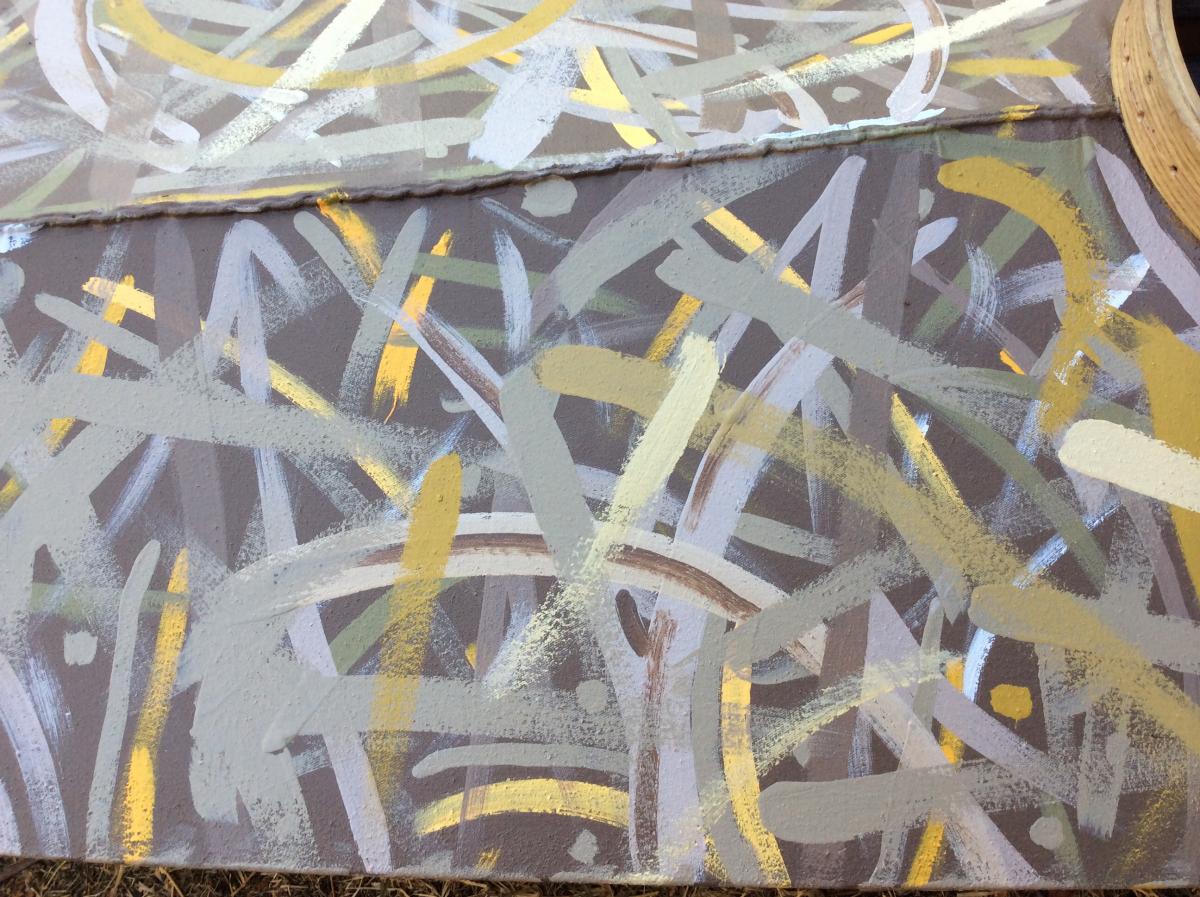

Thank you. Here's another shot.
I've been an artist for twenty plus years, so I've learned not to give up when a project starts out looking horrible. I have to admit I was a little worried for a few coats there...
Each color is a few tablespoons each. Not much paint is being added.
For about 4 hours I was beside myself, wondering how many coats of brown to cover it all up?!
Aside from that, painting a boat camouflage is a great way of refusing to grow up, if you're not using it to hunt. I'm responsible, but I try to remain as immature as possible. :P

If I merely congratulate you on a great paint job, then I feel like I am just echoing everyone else.  It's really impressive to me.  Teach us the method you used when painting camouflage.  It looks to me like you have to have all the colors going at once.
I'm glad you like the paint, all. I wasn't planning on camo, but once the subject was broached...
The most important thing to remember is all painting looks terrible up close. If you don't believe me, get close to an artwork at a museum. So, while you're working, remember to step way back to evaluate.
The method I used was very simple.
1) paint the base color
2) use one color at a time, I swear. For this method, just start slashing. Straight, curves, arcs, thick, thin, whatever.
3) lighten or darken (tint or tone) the paint color a bit and repeat.
4) change to another color. Go all Freddy Kreuger again. Repeat 2,3,4 until you are happy.
5) the layered look comes form using alternate layers of lighter and darker colors, and half painting over other stripes.
I use tablespoons to dip paint from the pots, which allows me to repeat colors by writing down the recipe. Two tbsp brown, one tbsp yellow, one tbsp white...
Honest. That's it. I confess I am an artist, but there is no art skill here.
I used three different brush sizes (1", 1/2", 1/4") and four colors. This was the same brown as the base coat, a yellow I found, and black and white. I never even touched my green... Some of you not living in a drought may be able to use green  :).
By twisting the 1" brush in mid-stroke, you can make thick-to-thin lines. Okay, that MAY qualify as an art skill, but I don't think so.
Make sure you distribute each layer's stripes evenly. Try to get each new layer to intersect or interact with the previous layer; lots of "x"es, <es, and >es. I found that if I started at the bow and worked around, I could start another layer. I worked with latex in full sun so I was able to do a few layers a day. No wet edge to be concerned with, here.
Grip the very end of the paintbrush handle and paint loose. Think grassy, leafy thoughts. Practice on a piece of cardboard, or an old sweat shirt. Or an old jacket and pants (where'd you get those slick camo clothes?)
You you could also make one or several stencils. That's what I would recommend for Kudzu's jungle camo idea. Which, how neat would a kayak painted like a SAC bomber be? Black or sky colored belly with jungle camo deck?
Also, you cannot mess up. No lines to stay inside, no particular shapes. Hiralonde was closest when he suggested 2 year olds do the work: that's the mindset we're after. Well, maybe 5 years old. That is my reported maturity level. I hope I don't ever act THAT grown up!
This forum is the only internetting I've ever done. I think it is virtually awesome that that we can all come together here to learn from each other and share our art.
And, thanks again, Kudzu.
