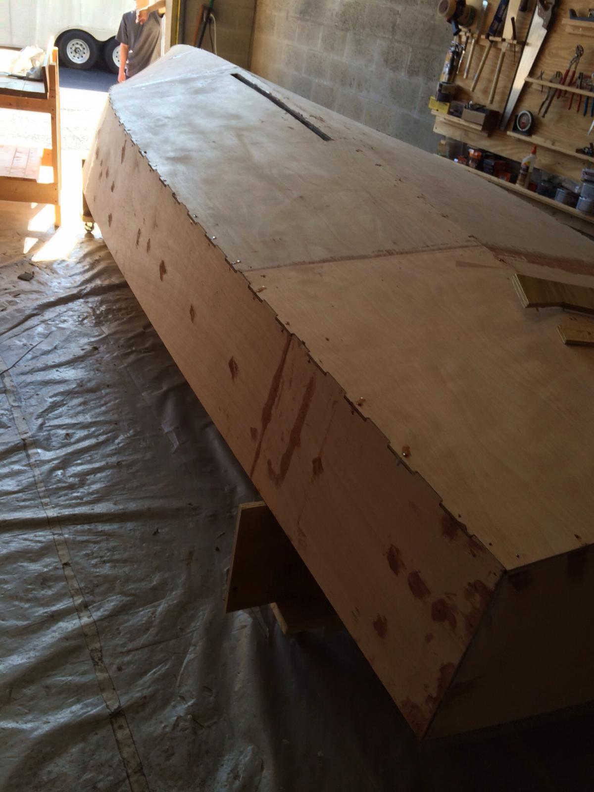

LennieG Posted April 26, 2014 Posted April 26, 2014 Thanks all. Picking paints should be easier but my nature is that I get tripped on these kinds of detail. Good news is that I will eventually get it right usually. I may just bite the bullet and use two part, figuring if I can build a boat I can paint a boat with boat paint. I and others flipped the boat this week and today I am working on it for first time in 7 weeks. I CANT WAIT TO BE BACK AT IT. Quote
