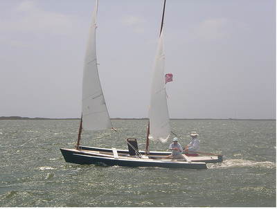

Exactly the reason my CLC John's Sharpie is now a trimaran. It was almost impossible to self rescue from a capsize, unless you were in shallow enough water to stand beside the boat. Bow is so fine it didn't float high enough to keep water out. CLC doesn't sell the kit anymore, and doesn't push the design. But as a tri it's a great boat- three Texas 200's under her keel so far.
LOL- True dat, but she's a MUCH safer boat now. Originally you NEVER cleated the sheet, and as a matter of fact , could not- there weren't any cleats. If it started to go and you couldn't IMMEDIATELY let go, you were over. Was a HOT boat, which is why John doesn't push it anymore- not a boat for novice sailors.
Now I feel much safer beach camping in her, and have seen 13.7 knots on the boat on a broad reach. First Tex 200 was sailed in winds up to 30 knots. I would never have even tried it before.
Graham designed the amas by the way.
