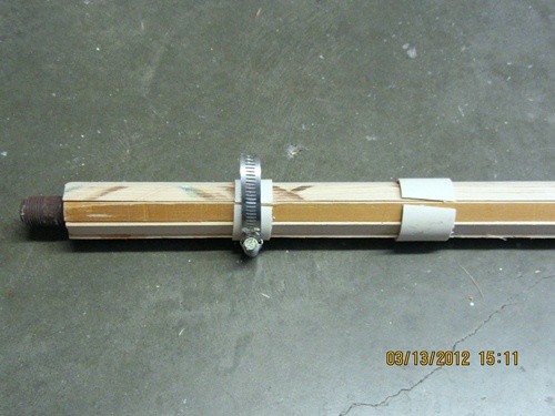

Playing around with a prototype stave shaft for a paddle. I was surprised, it only took me about 1 hour to cut out the staves with the "bird Mouth" grooves. It would even be faster next time now that I know the saw set up. I spen over an hour trying to figure how I was going to get the staves together. I tried tape, and rubberbands but wasn't successful. Than I can up wit the old "PVC Pipe" clamps. Worked great. I made enough to clamp it ever foot or so. To put it together I started stacking the staves in a clamp and laied a 1/2" X 6" flexible nipple in the center to stack the staves around. It was just big enough to hold them in place, but small enough that when I got the staves together and tighten in place I could tipe the shaft on end and they slid out. To really get the staves snug in place I put a hose clamp over the PVC clamp and tighten it up. I think it is going so work!

I have made some hollow shaft paddles too but have no table saw and wouldn't know how to use one anyway. My method would not be as strongly joined as yours but works OK. I buy lengths of quarter round and hollow it out on a home made router table then join 4 pieces to make the full tube. I use lots of cable ties to hold it and like you found I need something in the ends to make it hold shape while assembling. Mine have ended up between 30 and 35 oz using Tasmanian Oak (which is not an Oak at all).

Old bicycle inner tubes work really well also as clamps. cut out the valve stem an spiral wrap.. My double paddle weighed 31 ozs when finished :D
Now that you mention this, I remember reading about using inner tube some where in the past. Oh well, I didn't have any anyway but well keep that in mind. The hard part for me was getting them together. What is your secret for that?

Mine wasn't messy as it should have been because I was runnung out of glue so didn't use as much as I normally would have. Now that it looks like it well be a good useable shaft (Loom?) I wish I had gotten more glue. I think I will coat it heavily with epoxy and try to use it.
I lay out the strips edge to edge on a few pieces of duct tape, sticky side up. Squirt glue down each pair of joining edges, roll it up with tape - parts will sort of *click* together in proper alignment, then cinch the BM tube tight with zip ties spaced maybe 6" to 8" apart. Paddle shafts for stand up paddle board paddles. I also make masts the same way.

Coating with epoxy on the outside won't make it stronger unless there are slight external gaps in the joints that it can seep into. If it didn't glue up strongly enough then I think the only way to save it would be wrapping with a layer of glass - but this would offset a lot of the weight reduction.

My thinking was by painting it with epoxy before sanding, epoxy would soak down into the seams and increase the holding power. It way be okay as is, feels solid. I've dropped it several times and nothing has come loose.
