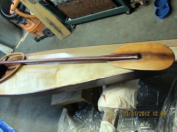

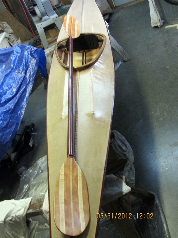

P Doug (WA) Posted March 31, 2012 Author Posted March 31, 2012 I finished up the paddle today. Not too bad, but required a lot of sanding. Next on will be easier and better. Before I do another one of these I will make a Greenland, provided I can find a straight enough 2x4 around here. I weighed this on my little Harbor Freight scale and it said it weighed 29.7 ounces. I don't have any idea how accurate that scale really is, but it does feel light. Quote
Hirilonde Posted April 1, 2012 Posted April 1, 2012 Looks good. Some time I will work on ways to get the weight down some but I doubt wood will ever get close to the feather weight of a carbon composite paddle. But unless you are racing or long distance touring I don't see that it matters all that much. And since one of the reasons I want to go kayaking is exercise it means I will get more in less time Quote
