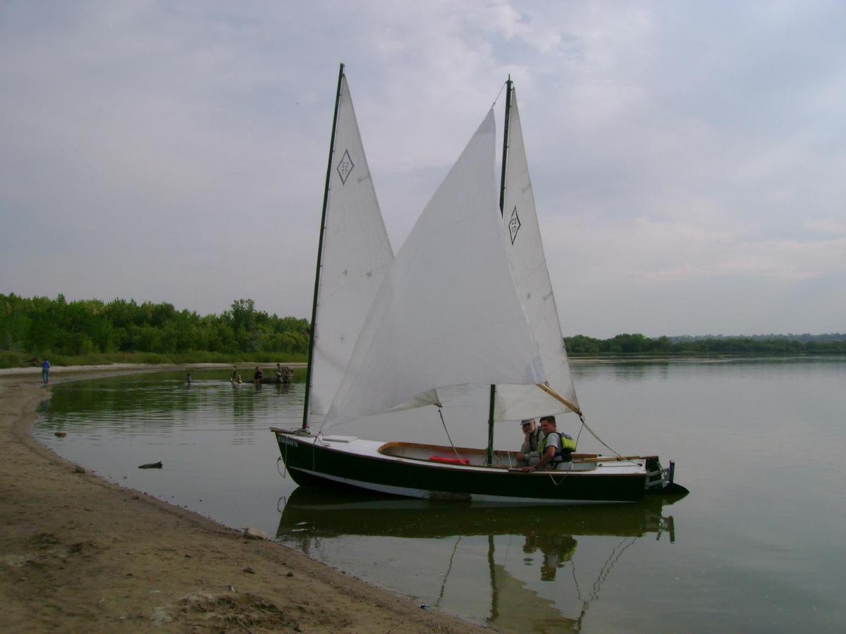

Michael Collins Posted February 15, 2012 Posted February 15, 2012 You have a halyard on the forward end of the mizzen mast. There is an eyestrap on both sides of the boat just aft of the main mastabout a foot back on the outside edge of the deck "Securely"screwed down into the inwhales. You place a hor cleat under the side decks aft of the mizzen mast about 2-3 feet back that you cleat off the fall of the halyard on the windward side to provide some staying forcees to the mizzen mast. The clew of the sail has a sheet attached that goes aft to a block attached to the end of the Mizzen sprit boom. Ray, if you are out in the boat this weekend, can you get any pictures? Sorry. Seriously, do you have any pictures? It has been a while since I have been in Doug's boat, but this sounds different than what I remember. I am hoping that images will help me remember if this is the way we have it. Thank you, Michael Quote

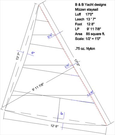

ecgossett Posted August 19, 2012 Author Posted August 19, 2012 Which edge of the sail do you hook into the padeye? The leech side (17') goes forward right?? Some of the photos look like sail was hung in different ways. Quote
wkisting Posted August 19, 2012 Posted August 19, 2012 On my staysail, I think the shortest side is the leech (running from head to clew). The foot is longer (from clew to tack). The longest side is the luff (head to tack). I'm going off my imperfect memory, but I think that's right. To put it another way in case my terminology is wrong... if you're looking at the boat from the side while the staysail is up, the shortest edge is located aft running (vertically) from the top of the mizzen mast down to the clew/sheet (usually attached to the end of the mizzen sprit), and the longest edge runs diagonally from the top of the mizzen to the padeye on the rail near the main mast. Does that sound right to everyone else? Quote
ecgossett Posted August 19, 2012 Author Posted August 19, 2012 Per this drawing that sounds right for dimensions. Quote
wkisting Posted August 19, 2012 Posted August 19, 2012 Yep, that's exactly how I remember mine being arranged. Quote

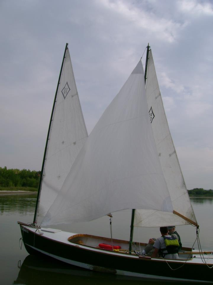

Peter HK Posted August 27, 2012 Posted August 27, 2012 Hi Edward The tack of the staysail attaches to the windward fitting on the gunwale. You have it attached to the leeward one. The main should be to leeward of the staysail ie the staysail is between the main and mizzen. Cheers Peter HK Quote
