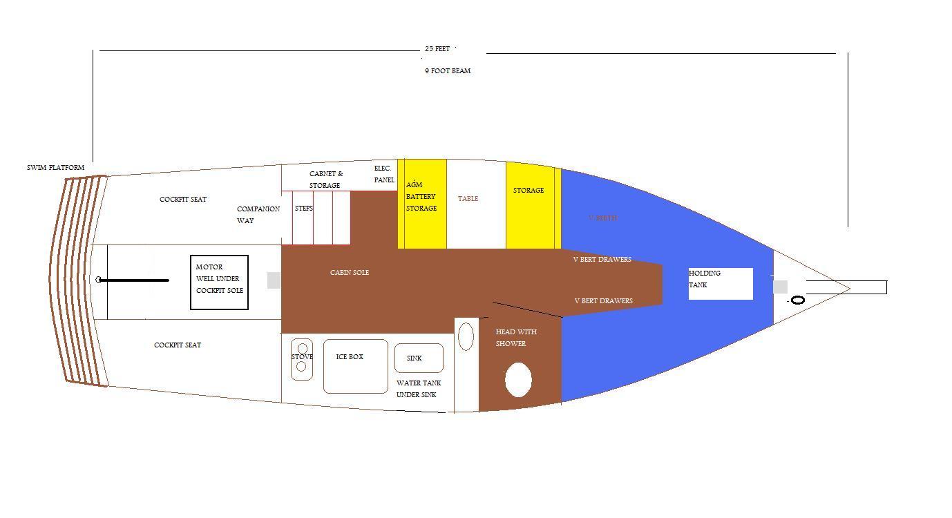

Scott Dunsworth Posted October 31, 2010 Posted October 31, 2010 Just thinking again :???: A 25 footer with near 6 foot head room and a bit beamy for 25 foot. I was thinking in the Belhaven looks with rounded chines strip built and a fixed keel. I thinking trailering maybe once or twice a year max. What got me to thinking is if a belhaven could be stretched about 25% all this could be possible. Also it could be built in the shop I now have. Unlike the 32 footer I was wanting. I know I could design the interior layout, but the hull shape and balancing would have to be left to a pro. I'll make a rough drawing of the exterior and post it. Graham please don't laugh to hard just feel pity on my sole. :sad: PS I hope everone is having fun at the messabout, miss all of you. Scott Quote
Scott Dunsworth Posted October 31, 2010 Author Posted October 31, 2010 Sorry I posted the wrong drawing the first time. Quote
Gordy Hill Posted October 31, 2010 Posted October 31, 2010 Hi Scott, I think you should keep the beam below 8'6" to be legal trailering in most states. I like the companionway offset, especially since the mizzen mast is right there, but it looks like you'd have someone step up onto the seat and then down the steps. I'd move it as close to center as possible taking into account the mizzen. If the centerboard were on the same side as the companionway it would leave a huge area on the other side for a double bed quarter berth. ....or a head with a jacuzzi ...or a dinette... The swim platform might require an inboard rudder. More problems than it's worth. Maybe a "sugar scoop" transom with a cutout for the rudder could work. I've been trying to mock that up on my own imaginary boat. You might want to swap the stove and icebox. It can really be handy when the icebox is also accessible from the cockpit. It's much easier to load the ice and a nice cold sasparilla is always close at hand. Quote
Scott Dunsworth Posted October 31, 2010 Author Posted October 31, 2010 Gordy I was wanting to have a fixed keel for a few reasons. Mostly to completely open up the interior to many possibilities. Also I was planning to have the rudder inboard to have a huge full swim platform. I am trying to get away from what I call the pop up camper sendrone. We would like most everything as permanent and in its place as possable. I don't want to have to move the sink to cook then move and put away the stove to do dish's. Etc..... We would like to be able to stay on her 2 to 4 months a year in Florida. So things for us at least must be pretty laid back and easy to access. We would propably do a marina 2 nights a week to get off the boat, fuel up,pumpout and water. I guess I am just trying to get 32 feet of boat into 25. As for trailering it would be once or twice a year max if that. We can keep a boat on Kentucky lake for about $800 year. Everywhere in the world is accessable by water from there, except inland lakes. By brother is leaving from there next week for 1,2,3 years for south Florida and the islands. So it's good place for summer sailing and within 2 or 3 weeks you can be in the Gulf. I like the big super insulated ice boxes that drain to the outside. Most production boats are designed to sleep 5-8 and waste a lot of space doing that. I think if one was designed for the comfort of two a 25 could be enough boat. One main reason I like the big swim platform, my brother built a one on his 25 Coronado and it is handy for the dink, swimming and a very good BBQ platform. Also he built a stainless rack for his solar panels to be completely out of the way. I think I can build this boat with 90% local red ceder for the hull and Birch ply on the inside, with good marine ply for the decks. I'm looking to build something a little more than a camp cruiser. As near to a liveaboard as a 25 can be. Scott Quote
Scott Dunsworth Posted November 5, 2010 Author Posted November 5, 2010 I laded my theoretical 25 out on graft paper to scale today and the interior layout works pretty darn close.I really believe maybe misguided, that this boat is possible if designed for two. Although the position of the masts may have to interfear with the interior after a pro balances this boat out. BUT, Can I get 5'10 to 6' head room? Without her looking like a very ugly duck is yet to be proved. Which must be very difficult because I haven't seen many production boats this length without a pilot house that are sweet to look at. The only way I can visualise this being possable is to have the cabin sole well below the waterline. That means a deeper than average keel. It seems like in one of my conversations with Graham a few years back he told me it takes around 28 feet to have standing head room on a boat to make it also pleasing to the eye. I hope I didn't misunderstand what he was saying. But it looks to my untrained mine if I can make her deep enough that the head room could be achieved. That kind of head room is only needed right down the middle of the cabin, so it really doesn't matter to me if she drafts another 6 to 10 inch's. Gordy brought up some intersting and legitimate thoughts about the wide beam. But trailering is my last concern, comfort is #1 I know with a deeper draft boat, and with a fixed keel I'll have to get out of some of the bad habits I have developed with my Belhaven. First I'll have to to start navigating shallow water which I have never really done. She just goes about anywhere, without much thought. While I'm talking about the Belhaven, I got to look over one of the more famous pocket cruisers around, the Montgomery 17 a very nice well designed boat. BUT I would not, personally take two new ones for my Belhaven 19. Another legitimate thought that Gordy brings up is the inboard rudder. Sense I am planning a fixed keel I'm not to worried about the rudder. I would like the motor (15 to 20hp) under the cockpit sole between the keel and the rudder. I'm not that worried about damage of ether being behind the keel. I know the type of boating I do ( a lot of rivers and the wind is ether on your nose or behind you) and a quite motor is almost as important as standing headroom so under the cockpit should do the trick. Just some more thoughts from a DREAMER :D Scott Frank I now realize I probably should have started this thread under designs forum, so feel free to move it if you wish. Quote
Tom Lathrop Posted November 5, 2010 Posted November 5, 2010 Scott, you are making a start on a long journey. I predict many many detours and changes of direction along the way. Gordy's comments are pertinent. You would tire of making that trip to the cabin real quick, especially if the boat is on starboard tack. You want standing headroom and don't want a pop up on a 25 footer. There is a reason so few are seen. Don't disparage the poptop too much. In warm climates, they are a blessing and standing headroom underway is overrated. Fine on a bigger boat but too many compromises on a smaller one. What is that motor well in the cockpit? Many 25 footers achieve low draft and a lift keel without intruding on the interior. 8' 6" beam is plenty on such a small boat and trailerability can become a great asset.. Quote

Scott Dunsworth Posted November 11, 2010 Author Posted November 11, 2010 My brother and wife are now cruising on a 25 foot Coronado and have told me basically there's no way to make a 25 that comfortable. I disagree, just for :grin: entertainment :grin: what do you all think????? Let her fly. I had one email that asked are you NUTS and another that said that it may possable but a challenge. Every thought is usefull in some way, so please let your thoughts go. Just remember my intended use for the boat. Scott Quote

Scott Dunsworth Posted November 12, 2010 Author Posted November 12, 2010 Peter I really like the 26 but no standing head room. Actually I visited Graham with the intentions of of buying the 26 plans and ended up with the Belhaven. At that time the 26 plans where not done but far enough along that I could have started one. At the time I thought it was only going to be me using the boat. With an occasional day sail with the family, so I went with the Belhaven. Also spending so much time aboard, the round chines would be a lot quieter at anchor. Now Ken I stated earlier no houseboats with a sail and nothing that looks like a Bolger ether. :grin: Maybe a lobster boat with a sail would work. :grin: A motor sailer! Scott Quote
