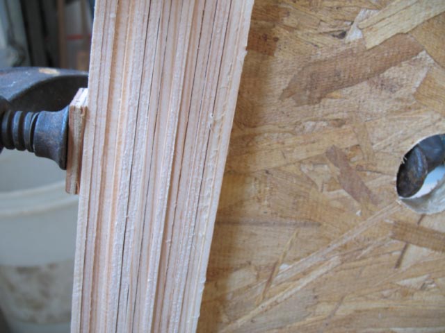

Joe Anderson Posted April 28, 2009 Posted April 28, 2009 I have cut out the laminations for the stem out of douglas fir. I tried various thicknesses to find one that would take the bend without breaking. Strips are just over 1/8 by 1 1/2. When setting up dry they were a handful. I am wondering if there is any downside other than extra time and epoxy if I glue the stem up in two or even three goes. There are a total of 14 strips to laminate. Quote
Hirilonde Posted April 28, 2009 Posted April 28, 2009 I think the only down side you will find is time. If it makes it easier to keep or get all the pieces into alignment and properly clamped that would seem a small price to pay for the results. I find that simply trying different things during the dry fit stage like you are already doing teaches me what I should do. It is much easier to figure out before you glop it all up with epoxy. And if you are finding it awkward with the pieces dry, you will find it even worse when wet and slippery. Quote
Tom Lathrop Posted April 28, 2009 Posted April 28, 2009 There are many methods used by woodworkers but here is mine when doing a large stack of laminates like this. Fit them dry as you have done. Drill a hole in one end through all laminates and into the form. Make the hole a tight fit for a nail of, say 10 or 16d. Take apart and slap on the epoxy. Cover form with plastic. Insert the nail through laminates on a flat surface. Fit the end of the thing back on the form with the nail driven a bit into the form. Progressively wrap the laminates around the form, keeping the edges lined up and clamping as you go. Oh yes, start at the end with the greatest curvature. Wooden screw clamps protected with duck tape are good to keep the pieces lined up together. Quote

Joe Anderson Posted May 6, 2009 Posted May 6, 2009 Tom, Thanks for the suggestions. I found them very helpful. Fortunately the shop was at 55F so I had plenty of open time. It was an armful getting the laminates all epoxied and clamped in place. The preparation and dry run made it manageable. Quote

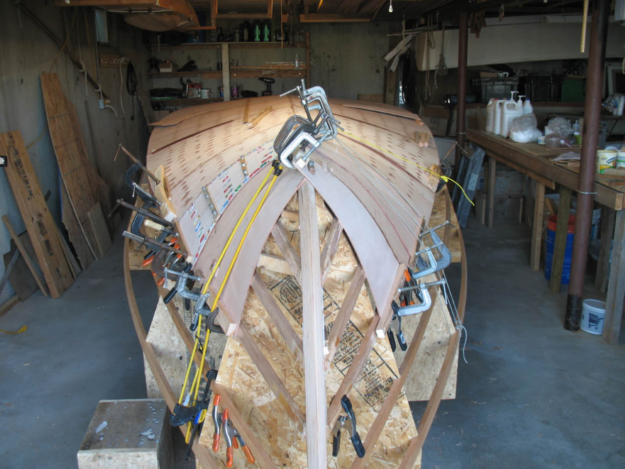

Joe Anderson Posted August 10, 2009 Posted August 10, 2009 I have been working on planking the hull. Quote

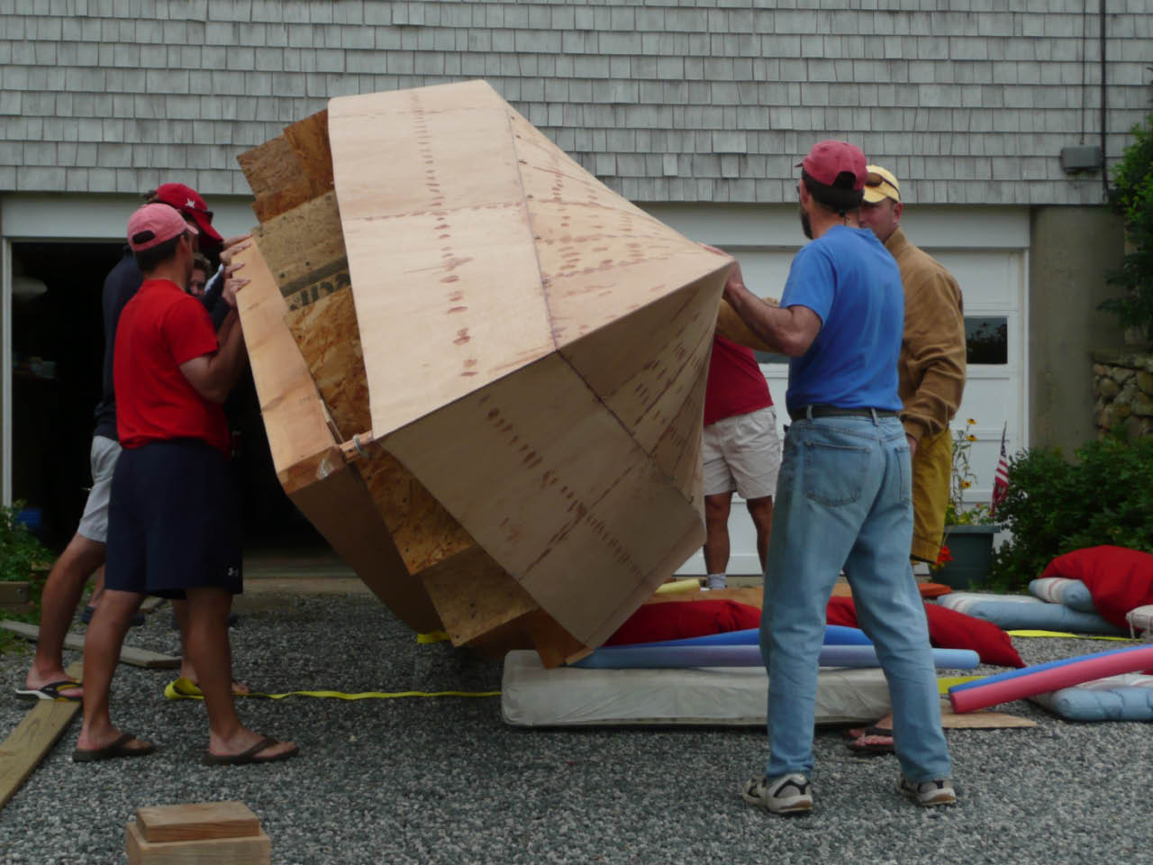

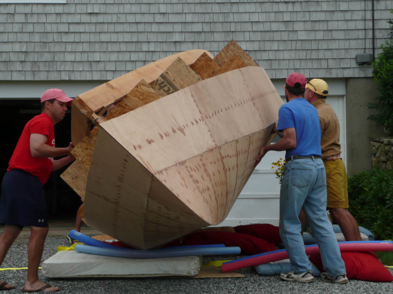

Joe Anderson Posted August 10, 2009 Posted August 10, 2009 The hull at this point is held together by a wing a prayer and a dab or two of epoxy. I was a little concerned about rolling the boat. Quote
