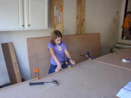

I was inspired by lbrewer's boat building enthusiasm and made some progress on the build.  It helped that my son did not have any soccer games this weekend.
I cut out the sides, bottoms, transom and forward bulkhead.  Managed to cut some other smaller pieces as well.  I am using a butt joint to join the side and bottom pieces so I need to get that setup and let it cure.  I hope to make some progress on that this weekend.  I recently got into using hand planes for my other woodworking projects and found the block plane a great tool for tuning the cuts made with the scroll saw.  Less stressful to cut outside the line with the scroll saw and then clean it up with the block plane.
Posts below show a couple of my "helpers".
