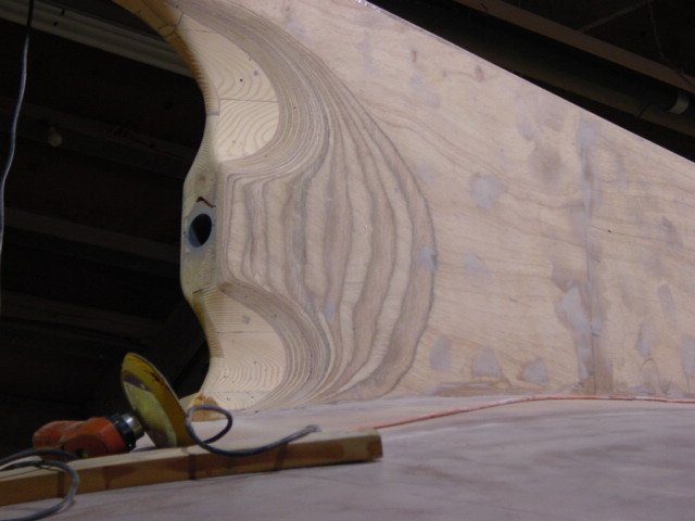

I should point out for the viewers in computerland, that is one BIG hunk of wood! 3 layers of 2x6 Fir, cross laminated followed by 2 layers of ply on either side. There is a gantry and chain hoist just out of the picture that we used to lift it in place. If I had to guess on the weight it would be around #400+ at this point. There are still more pieces to laminate onto it as well.
The pictures of this boat just don't give a good perspective of how big it really is.
ID of the bow thruster port is about 10-12".

John, can you walk us thru the process they used to cut in that bow thruster tube? I'm guessing that they didn't just 'eye ball' it. There must have been some sort of template.
A scrap section of the thruster tube was cut to fit 'inside' the bow. The angles were rough, but close enough to get it into position (there are a few measurements taken from the bulkheads in the bow section). It was leveled and placed perpendicular to the centerline of the boat also.
From there it was traced around the circumferance of the tube (on the inside still). The tube was removed. A long drill bit was used to drill 'marking' holes to the outside. You had to change the angle of the drill so that the projected line was continued to the oustside of the hull (hope that made sense).
We then went to he oustide and scribed the outline of the intended hole, using the drilled holes as guides. Used a sawzall with a 'very' long blade and cut the hole out. Here again, you had to change the angle of yoiur cut to keep the inside of the hole perpendicular to the hole. Or maybe a better way of saying it, is to kep the inside of the hole parallel to the tube.
That hull is 1 1/2" thick at that point, when it is cut at the angles required, you are making a cut through up to 3-4" of material. We went through a LOT of blades!! And yes, there was a lot of smoke there also. ;) ;)
Any gaps were filled with thickened epoxy. There is a large built up fillet in front of the tube that you can sort of make out in the picture. That is to deflect the water from the tube while cruising. It is somewhat dished out on the aft side of the tube for the same reason.
I hope that answers your question.
