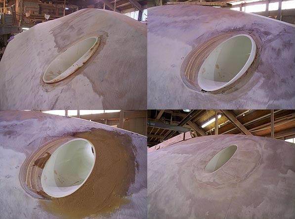

  7. Bow thruster

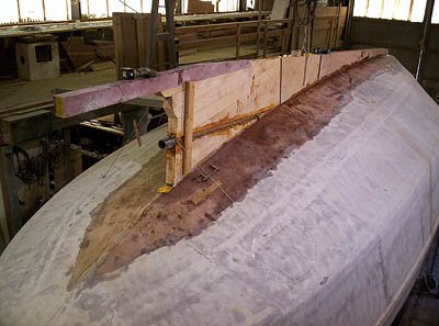

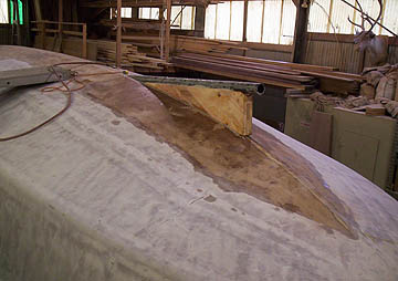

  8. Added the keel today

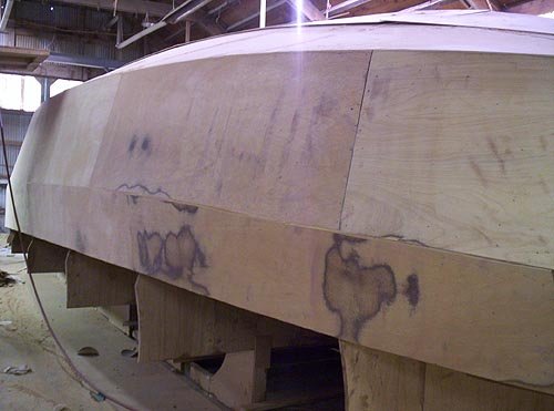

  12. Wrapping up the cold molding.
  13. The hull has been "straightened" and all tabbed in place and all wires and screws removed. Yesterday we did the first of 4 layers of 1/4 plywood cold molding on the 4 bottom panels. The 4 side panels will get three layers. Will try and remember to get some pics. ---Joel---
