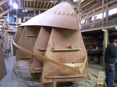

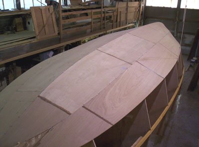

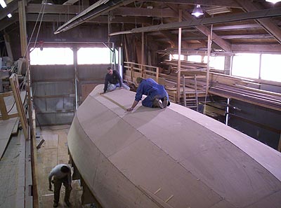

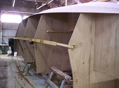

  13. The hull has been "straightened" and all tabbed in place and all wires and screws removed. Yesterday we did the first of 4 layers of 1/4 plywood cold molding on the 4 bottom panels. The 4 side panels will get three layers. Will try and remember to get some pics. ---Joel---

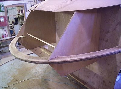

  18. Ran into the first snag, the lower side panel (not shown on the pictures) would not fit properly around the stern. Lofting off, plywood to stiff, a combination, who knows... We hacked off the last 9 feet of the panel and bent a sheet of 3/8 Okoume around the stern, traced and cut it out. The great thing about Okoume is that it bends nice. Will just butt joint the two pieces with a backing plate for now. ---Joel---
