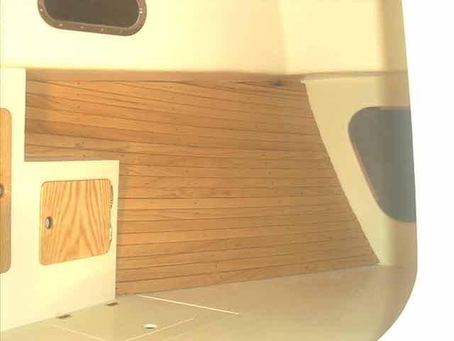

Charlie Jones Posted December 17, 2005 Posted December 17, 2005 Greg- yes we did insulate behind the ceilings. We used foil both sides urethane foam between the cleats, cut to fit snugly. Here's a shot of Laura fitting one piece and one of the fore cabin foam all installed, ready for the ceilings.. Quote
