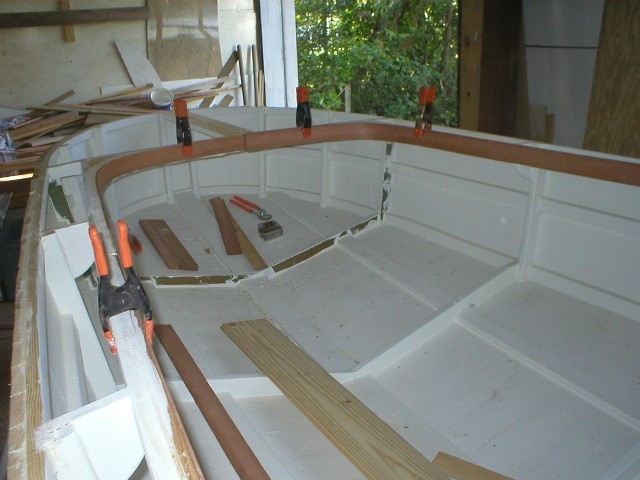

capt jake Posted October 29, 2005 Author Posted October 29, 2005 I may get out yet this winter, we'll have to wait and see. Stump, I have seen several motors for sale recently, pretty reasonable too. Craig, cold water! You don't know cold. Oyster, I really don't think you bored anybody. To the contrary, I think you had most of us enthralled with our progress. I have completed most of my modifications. 1 - New dock lines 2 - counter weighted the rudder 3 - Manufactured a gaff bridle saddle and re-rigged. (I'll have to get some pictures one of these days). Bronze plate and sheaves. 4 - 1/2 oval on the keel 5 - steps on the tongue of the trailer (to keep me feetsys out of the cold water). I have a fiberglass canoe in the shop that needs new gunwales. I tried to talk the client out of it as the boat is pretty shot. He is inistant about saving it. :roll: I have most of the old polyster resin glue ground off of it (read, most). He'll get Southern Yellow Pine for the seats and WRC for the gunwales (if I ever get motivated on it). Quote

capt jake Posted October 29, 2005 Author Posted October 29, 2005 Well Dingo, I am taking a similar approach now. somebody else suggested making them out of marine ply. Being as I don't have any 3/4" ply on hand; I just glued up 3 pieces of 1/4" instead. I had losts of pieces of that, so the price is right. Should be plenty strong at 15 plies in 3/4". Trying out some of that Gorilla glue on this as well. :shock: It seemed to work fine on the oars I made. I'll let them cure (duh! ) and then drill a hole in the center of each square (7 5/8"). Then chuck it to an arbor and into the lathe. Shouldn't be too hard to replicate 6 of them. Quote

capt jake Posted October 30, 2005 Author Posted October 30, 2005 Those are nice pictures. Oyster, are those pictures of your current project and teh one you recently completed? I have three of the hoops roughed out. While cutting the inside (on the lathe) there was a bit of tear out on the opposite side. Oh well, I was wishing them to be a tad thinner anyway! Off to the disk sander, the really large one. Quote
