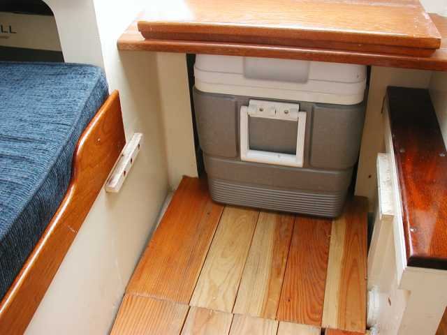

As finished, the cabin is 10 feet long from the anchor locker bulkhead to the after cabin bulkhead. The berths are 6'10" long along their centerline.
The cabin is 66" wide between cabin sides at the after end of cabin.
Headroom is 51" at the bottom of the companionway, not counting the extra height under the companionway slide.
Six adults can sit facing each other on the berths with plenty of room. I'm thinking of getting up a game of 88 (dominoes) :lol:

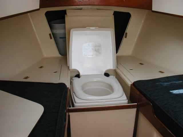

TV
Thetford 555. Same one I bought for Tehani after seeing the one we put in for Travis.
4.5 gallon holding tank, balances well when carrying full. In fact, balances better than the smaller one we used aboard the last boat.
