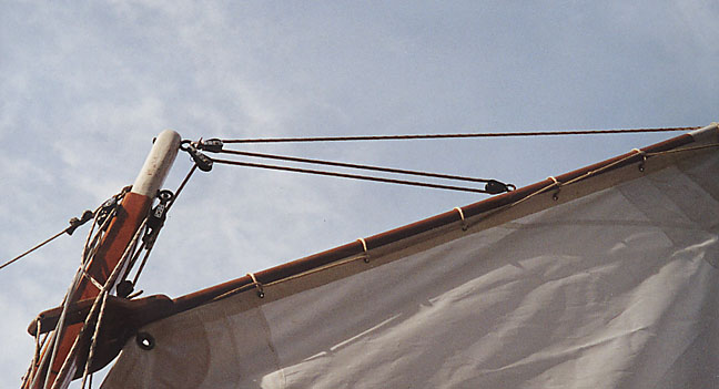

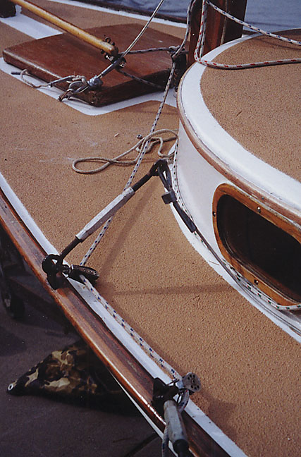

MikeStevenson Posted August 26, 2003 Posted August 26, 2003 Here's a pic of how Peter has his Weekender set up now. As you can see, we're using a double pulley for the throat halyard and running a two-to-one purchase now. You could use a single w/becket. At the deck we've got this going now: The same set-up is used on the starbord side for the peak halyard so it can run back to the cockpit side. Mike Quote

MikeStevenson Posted August 27, 2003 Posted August 27, 2003 Good point Buck: The sequence of tightening the gaff is important. I've found that dropping the peak so the gaff is at least level makes everything much smoother-running. Mike Quote
