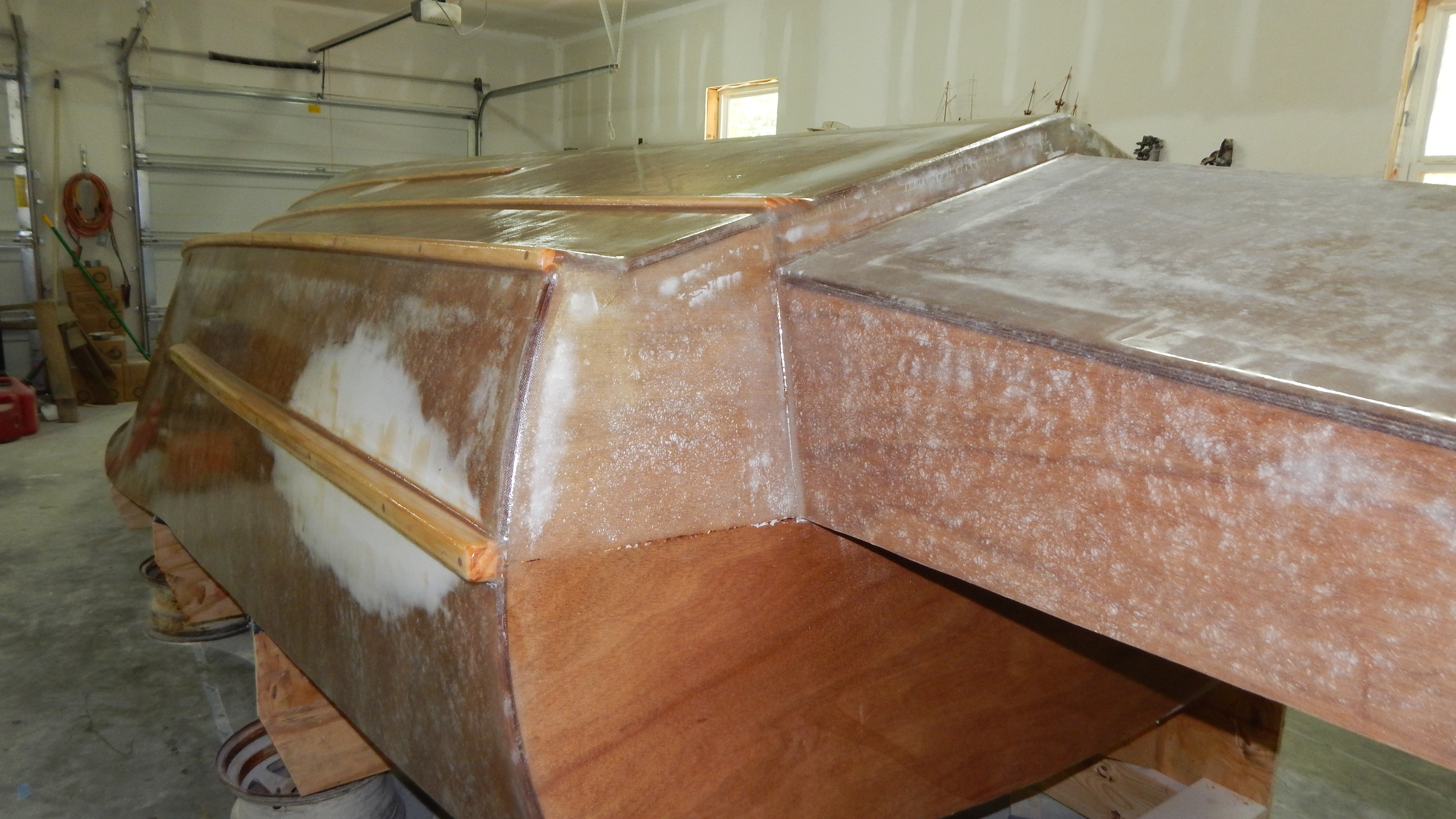

Riggs Posted June 2, 2018 Author Report Share Posted June 2, 2018 So after a rather nasty week. ( I had to put my hound to sleep due to her fear of thunderstorms which has been ongoing for 4 years, she was getting very destructive and my wife and i were hostages in our own home. ) Nuff whining The Boat has been turned over which was a task in itself but only due to my gravel driveway. Turning it over was not very hard but the piano dolly's i had under it did not do well when they ran of the plywood onto the gravel. That being said it is done and i am very happy with the end result. I think we had a bout 9 or 10 body's . here are a few pic's I think this might be the largest 20' boat i have seen and is starting to look right sexy like 1 Link to comment Share on other sites More sharing options...

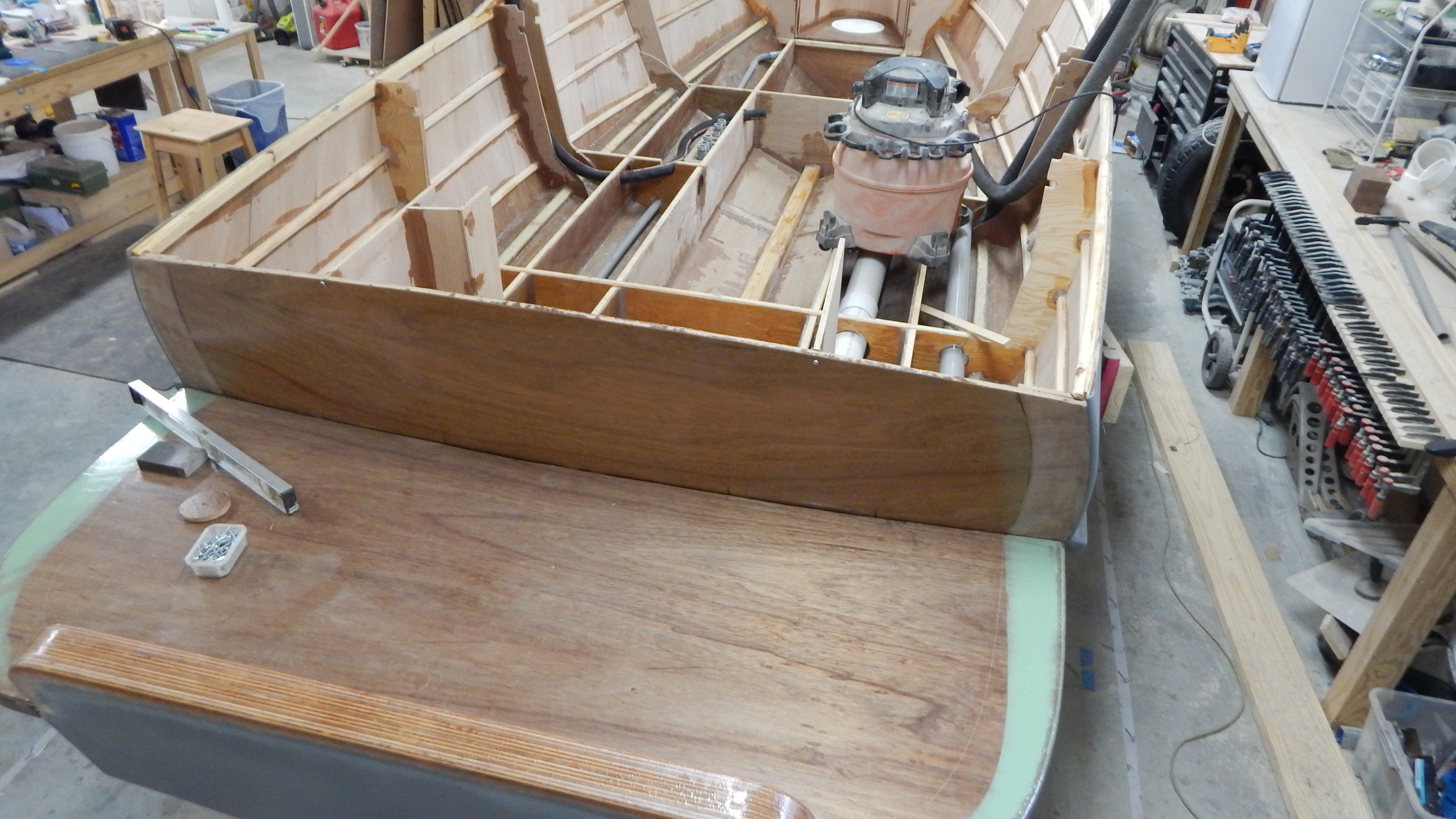

Riggs Posted July 6, 2018 Author Report Share Posted July 6, 2018 Yes lenm it will be self draining. My issue is in my wisdom i have placed a fish box, live well and electrical compartment across the entire transom. My plan is to use 2 Ball type scuppers through the transom into the compartment below the live well and the same on the starboard side, then with pipe bring them through the bulkhead onto the deck level of the boat. It looks to me like there is a good few inch's right next to the bracket web's. The pics show were i am planning on the pipe that will come through the bulkhead which is not there yet . If anyone has a better idea please please tell me. Link to comment Share on other sites More sharing options...

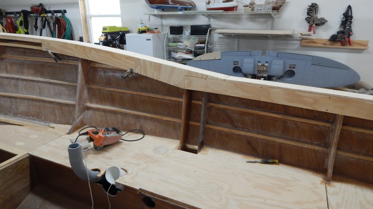

Riggs Posted June 21, 2019 Author Report Share Posted June 21, 2019 Bee doing a little more on the OC20-B dry fitting the gunwhales, decks and fore deck. made some hatches and am generally just beavering away at it. I have a little bit of concern over the profile on the fore deck but i think if i remove it and cut away a little more on the shear right up by the bow it should sort itself out. My wife say's i am just over thinking it but i am sure there is a little and i mean little run of. The first second and third pictures show it. The forth is my new helper sleeping on the job 1 Link to comment Share on other sites More sharing options...
