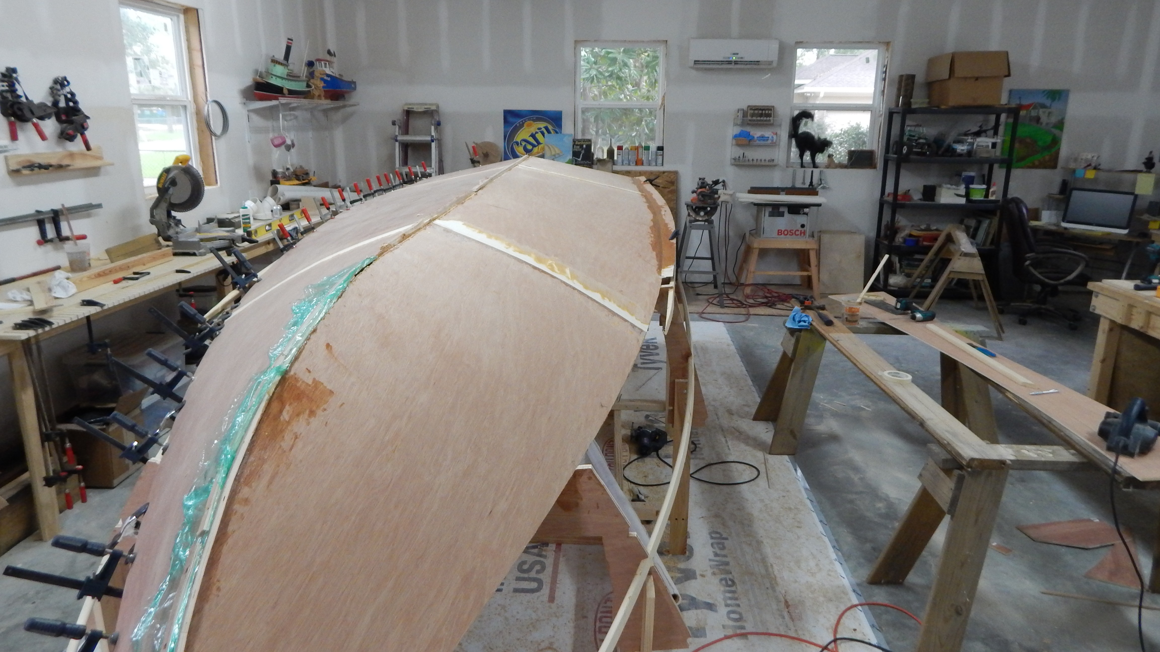

Riggs Posted September 8, 2017 Author Posted September 8, 2017 Airco unit went down early in the week so after replacing both main boards inside and out it is back up so Glass work is underway. Not my fav as it is just plain messy. Oneside of the bottom on and will go from there. Quote

Riggs Posted September 10, 2017 Author Posted September 10, 2017 I kinda golden for a while as i just finished building her a she shed She is an artist and now has her own studio. On another vain i am starting to think about turning this over. I am an army of one so have to plan. In my shop i have two 16 1/2 " x 7 1/4 " beams overhead. I placed em when i built it with this in mind What do you guys think about two comalongs and a swivel on the bow to lift and turn off those two beams Quote
PAR Posted September 10, 2017 Posted September 10, 2017 Come-alongs are possible but a really slow and tedious way of doing it. Consider simple tackle, maybe 4 - 5 part at each end or with some experimenting find the CG point and put it in the middle. Your boat doesn't weigh much at this point. Quote
