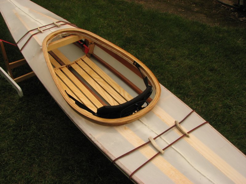

  2. Here is my kayak painted white.
  3. Here is a photo of my leather rigging. I used 5/16" strips cut from a latigo strap sold by Tanty Leather. For toggles I used Deer antlers cut and drilled. I finished my kayak so it would be transparent, then a year later I painted it white.

  11. Here is a close-up photo of the pulls
