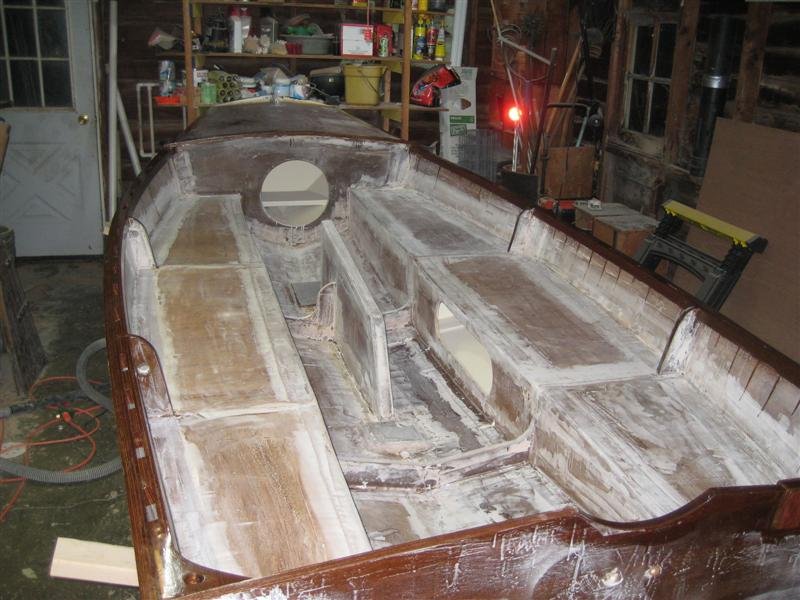

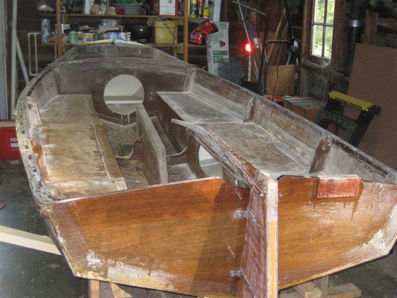

Here is my project that has been in progress much longer than I am willing to admit. Most of my progress has been done in the last couple of months. She is a Bateau CV16, a pram style sloop roughly 15 feet long.
