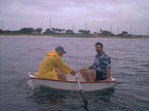

  16. Though my eyes were going bad Somewhere I have a pic of my first MiniPaw with 600 (* edited- 500 pounds)pounds in it at a BEER Cruise. I'll try to find the CD it's on. ALL great little boats. Found it. Here's a 6'6" MiniPaw with over 500 Pounds aboard Mike claim's 325 and I was at about 170 or so
