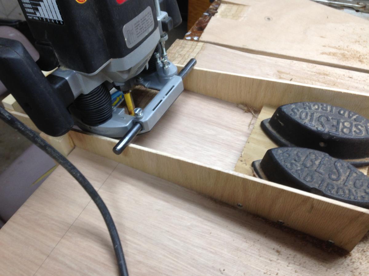

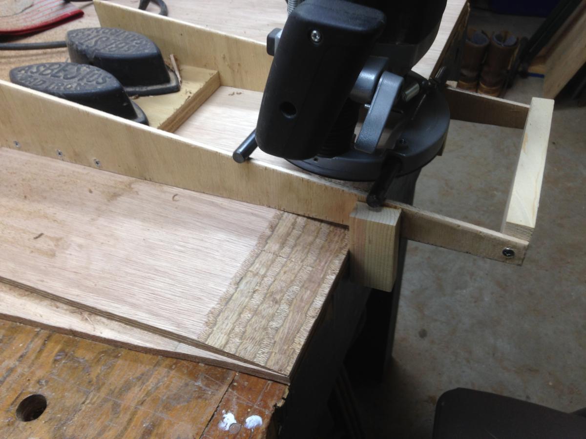

Don Silsbe Posted May 25, 2016 Posted May 25, 2016 I hear you, regarding getting sawdust all over your wife's car. It happens here on a regular basis. For scarfing, I use either a standard hand plane, or the routing jig shown in the attached photo. I like the hand plane for this, over my power planer, simply because it is a slower, more controlled process. (Key word here being "slower".) What I don't like about the router jig is that you need to make successive passes AND scoot the jig from side to side. It does provide a nice, precise angle, though. The plane provides a smoother surface than the router jig does. But the joint is concealed under thickened epoxy, so nobody sees the lumps and bumps. Just make sure you remove any high spots with an 80 grit sanding block, if you use the router. The epoxy takes care of any low spots. Quote
