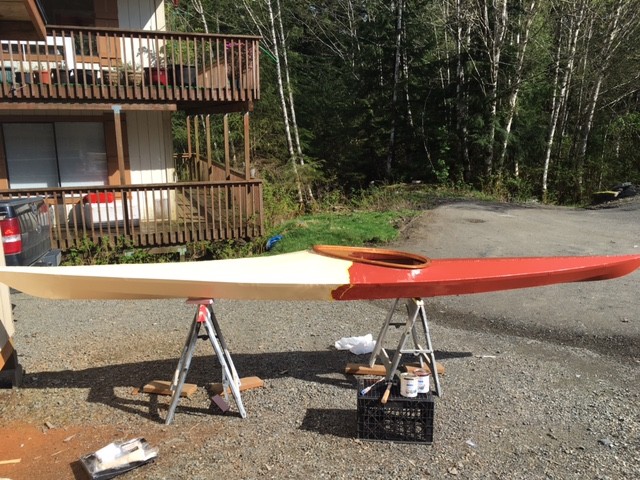

Abyssdncr Posted April 9, 2016 Posted April 9, 2016 That looks pretty cool! Can you take a pic of just the coaming area? Quote
flynfysh Posted April 10, 2016 Author Posted April 10, 2016 I will when the painting is done..there is painters tape on it now hiding the real design Quote

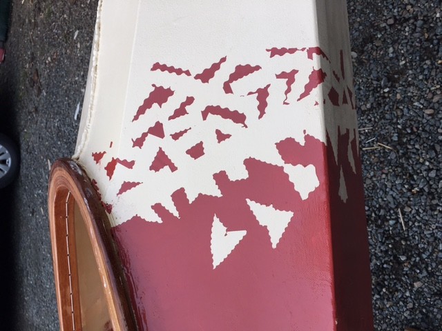

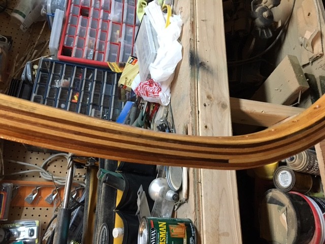

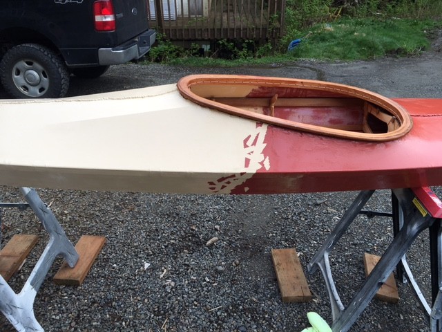

flynfysh Posted April 14, 2016 Author Posted April 14, 2016 here are pics of painted coaming area of my first kayak and new coaming for the second one...not done yet but getting closer 2 Quote
Action Tiger Posted April 14, 2016 Posted April 14, 2016 Oh, that's a very nice effect. Was it just random artistry, or did you have some inspiration? Quote
Abyssdncr Posted April 15, 2016 Posted April 15, 2016 That's a clever transition. Even if some of the paint bleeds around the maskings, you'd never really know - I like it! Quote

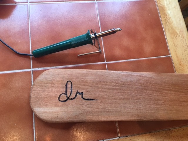

flynfysh Posted April 26, 2016 Author Posted April 26, 2016 last night my kayak past the "pinhole light test" for the first time...celebration!!! I was afraid I had used too much paint and that the boat would be too heavy....with all the gear, minus the spray skirt it's 31 lbs. I also finished carving my Greenland type paddle. With the paddle I decided to burn my initials into one of the blades. When I got done with that I wondered if the burner could be used to cut the fabric, it says that it heats to 950 degrees F and comes with multiple points. I tried it on some scrap pieces from my first boat and it seemed to do a good job...if it works cutting the fabric on the second kayak I'll try to report back. The burner was hugely expensive at $14.00 at a local store (just saw it at Amazon for $10.00) BTW I am smiling in this picture, it's just hard to tell from the outside Quote
Action Tiger Posted April 27, 2016 Posted April 27, 2016 I use a cheap soldering iron with the tip ground to a blade like shape to cut uncoated synthetic fabric. Works great. My one life long buddy (we're talking greybeard childhood friends) smiles just like that. Well, maybe not that wide. Quote
