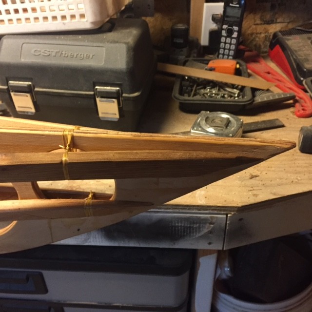

being one of those guys who reads 3/4 of the instructions in skim mode I realized that with 99% of my Vardo frame done that I had attached the bow and stern stringers in a different manner than I see many others on this forum have.
After I had sawing and fitting I glued (with Titebond III) the ends of stringers to the bow/stern plywood and then lashed one side stringer to the opposite side stringer (picture) . I have noticed other builders drilled holes through the stringers and lashed them closer to the bow/stern, do you think that is necessary or do you think my way will work?post-5556-0-03555000-1457394615_thumb.jpg
I think you'll be fine. I've done it much the same many times. If you had not used glue then I would say that you would be better off lashing right on and thru the stem pieces.
   I don't care to use glue on these boats in places I can avoid it so I drill and peg the stringers to the stems as well as lashing.  The main thing is to get a good attachment to the stems to keep things from shifting.
A SOF hull is some what flexible when finished.  This is actually a good thing, it is part of why it is so resilient.  Glue joints do not like to be flexed or twisted.  It might be that the bow and stern joints for the stringers move so little that glue will work fine.  It has been proven over an again that lashing works  and stands up to flexing for a really long time.  The only glue I use on a SOF boat is the 2 or 3 components that make up the bow and stern and for laminating the combing (but that is a different subject).  It is more for convenience that I glue the bow and stern assemblies as it keeps them exactly in position to each other while lashing.  If the joinery of these pieces is close then after lashing the glue becomes unnecessary.
My suggestion at this point would be to add lashings as Jeff describes in his books, plans, manuals and videos.  Then if the glue fails it won't really matter.
thanks guys, after due consideration I decided to do half of what you said and am adding pegs , but leaving the lashing as it is. When I sink later on I'll rue that I didn't heed all of your advice.

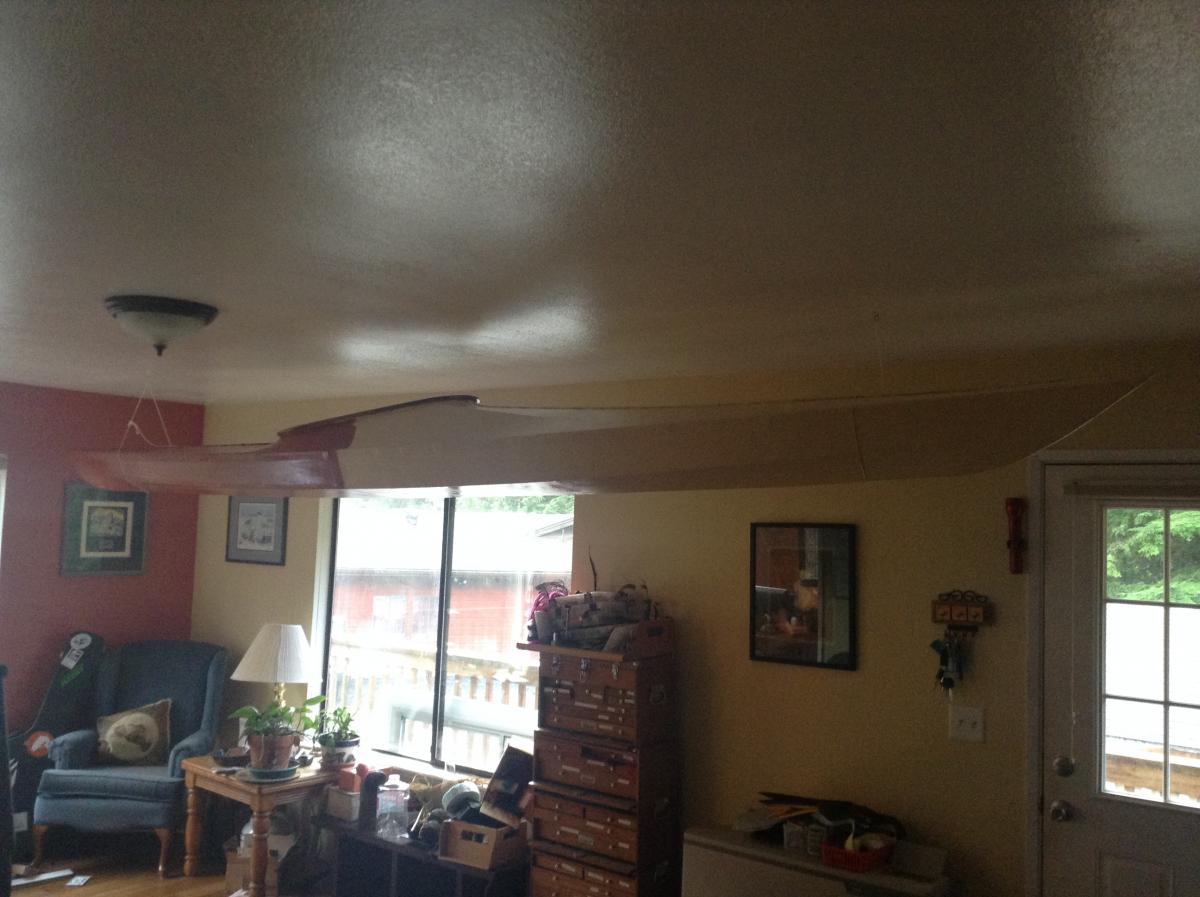

the fabric did get bounce-a-dime tight and I've almost finished the paint work (one coat more).  It's now hanging in my living room to cure awaiting final (hopefully artistic) painting. I looked for other woods for the next coaming but may have to go with the red cedar again and find a harder coat or more coats of varnish.

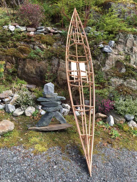

the second kayak is all framed and the tung oil is drying. I am about to laminate another coaming and was going to buy a clear fir 2x4 to cut and use...but...I read in another woodworking forum that kiln dried wood doesn't bend well. For my first kayak I use red cedar that I got from the stock of an old boatbuilder who cut and air dried his own lumber. I traded some flying for (4) 1 3/4" x 16" x 16' rough saw red cedar boards that I planed and cut and used both for my stringers and my laminated coaming. The only problem I had was the cedar seemed soft for the coamin.
