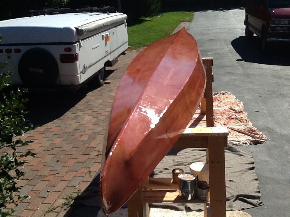

Cory's Skin Boat School has completed about 1400 boats, and Spirit Line is what they use. I finished my Kayak this month and its what I used.
I did not get an automobile show quality finish on my Kayak, but I think it's finish will draw positive attention. It's a working boat, it's a very durable finish, and I like the pigmented transparent look.
Spirit Line has issues with the coating that went ontop of a builders art work that is addressed in the application instructions. I would also not store any on our boats in direct sunlight unless an aluminum paint was used as a UV barrier. Spirit Line goes on clear. I am very pleased with its apparent durability, and it does need to babysat after application while it sets up in order to take care of the runs that develop. For color, pigment can be added, or he has a product and method of dyeing the fabric before applying coating. I watched his application videos, and have completed one boat and now could nearly match the videos speed, and get a similar finish if no foreign objects (bugs) contaminated my surfaces.
