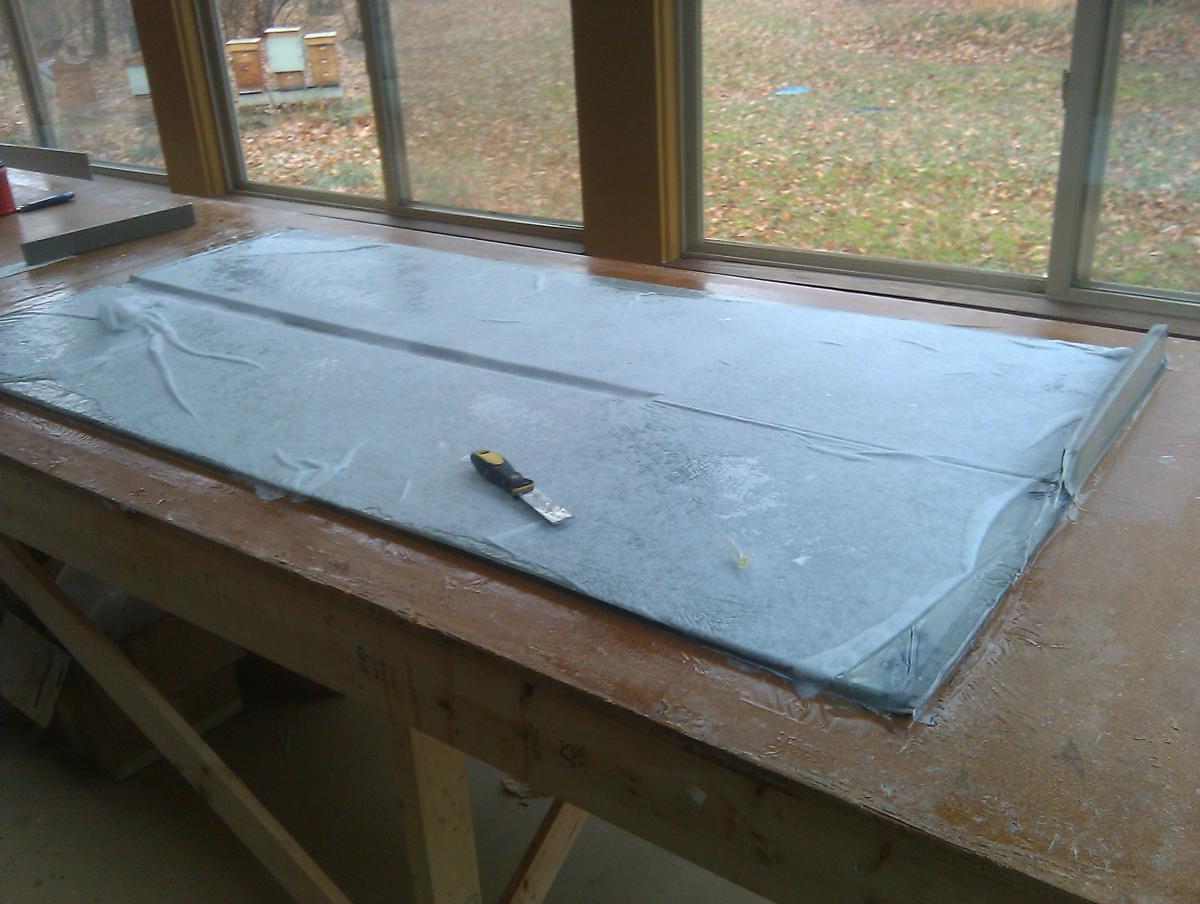

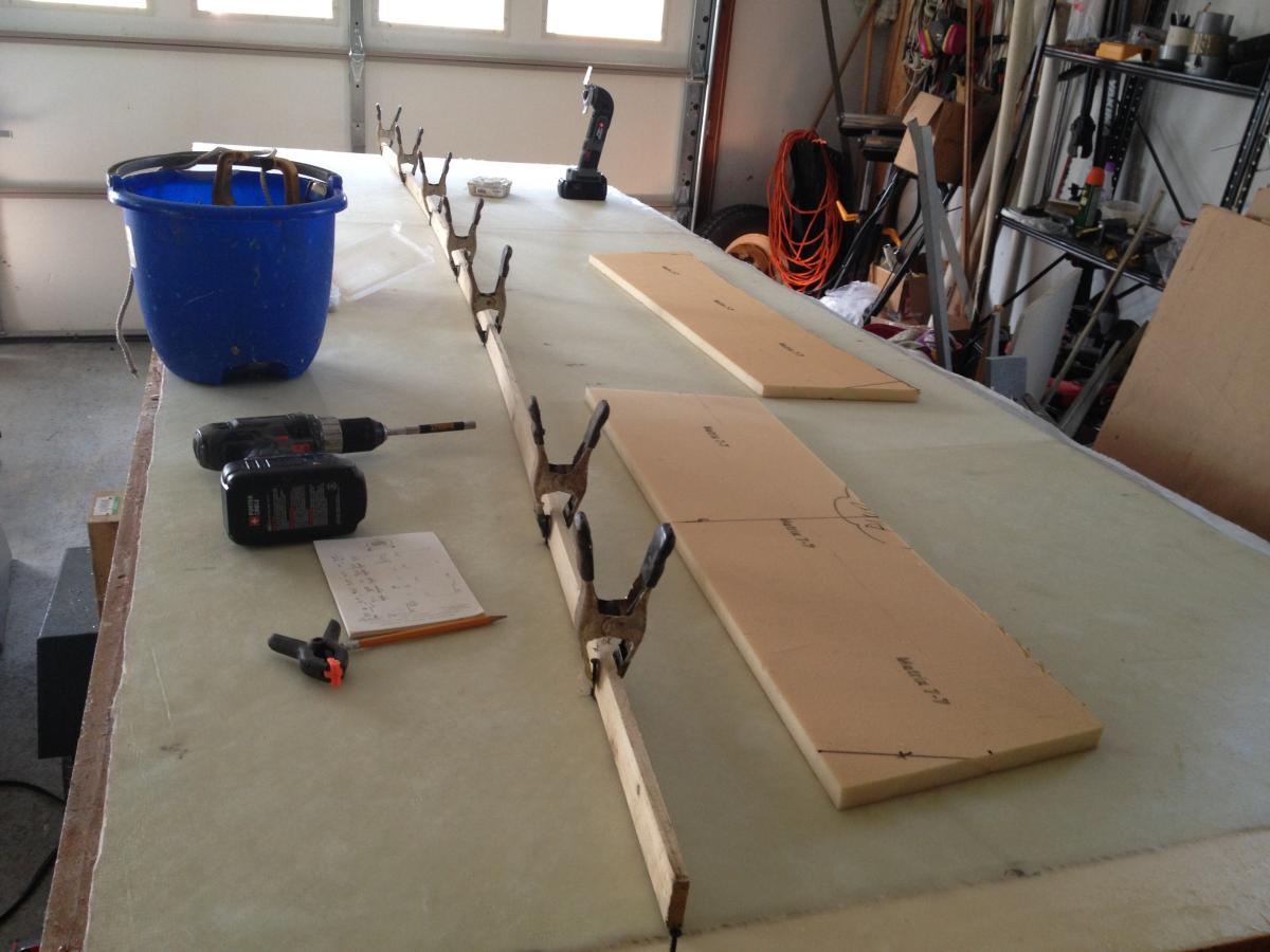

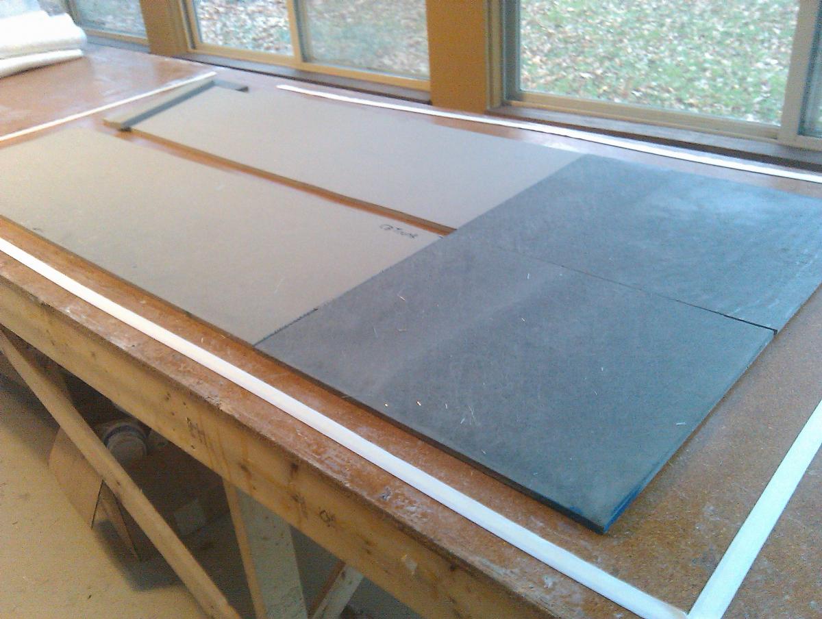

The trunk is built from high density foam up front around the hinge pin, with lighter density foam aft.  The pieces are cut to rough shape and laid out on the laminating table.

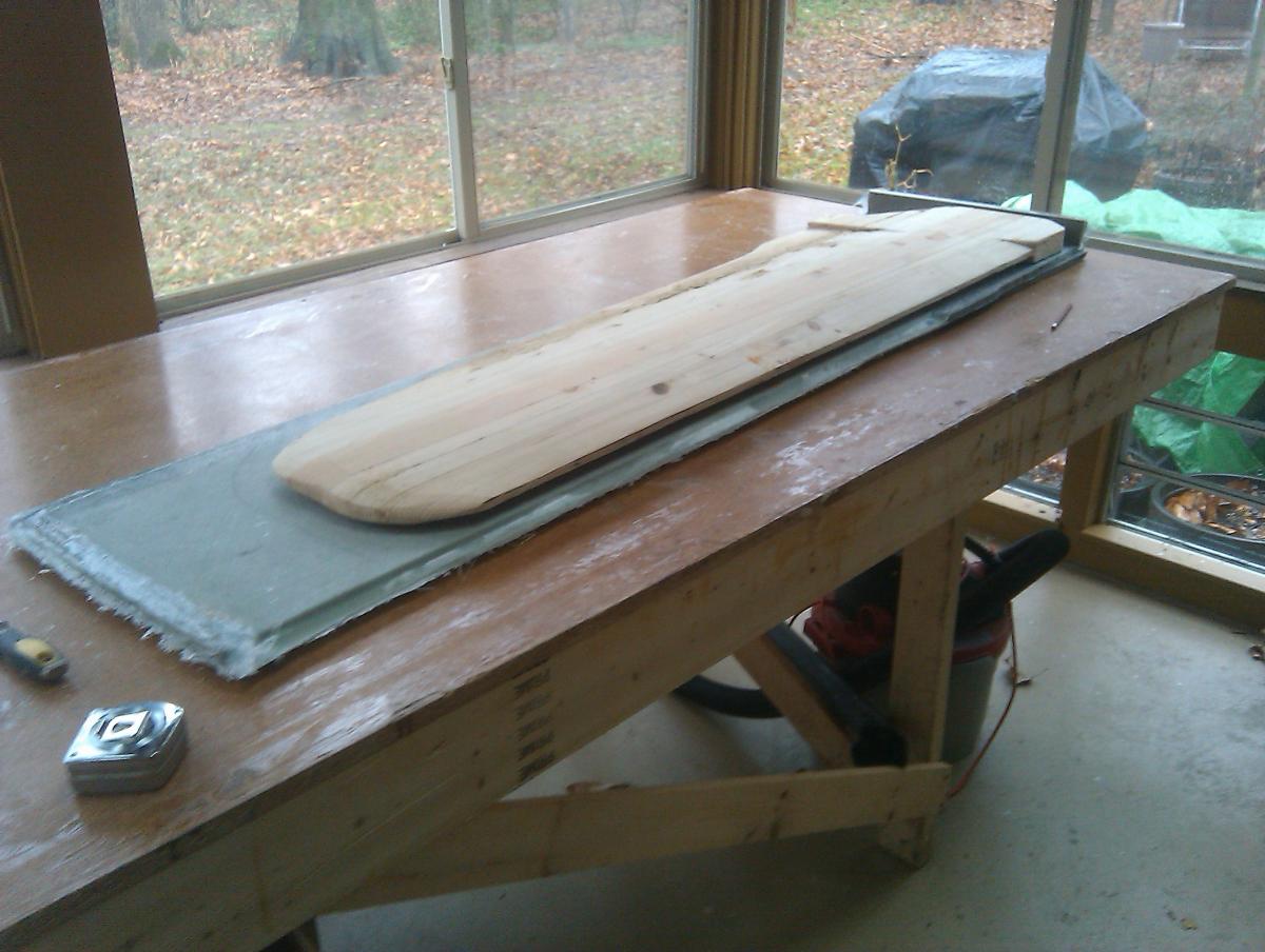

The trunk is shown after vacuum bagging one layer of 1708 on the outside, and two layers on the interior.  There is peel ply and bleeder cloth on top of the lamination that is about to come off.  Once the peel ply and bleeder are removed there is a smooth hard surface waiting underneath.
  There is clean up of the edges and trimming prior to fitting to the hull that will wait till later, but here is the roughed in centerboard laying in the trunk.  The trunk is longer than I am tall, reminding me again this is a big boat.

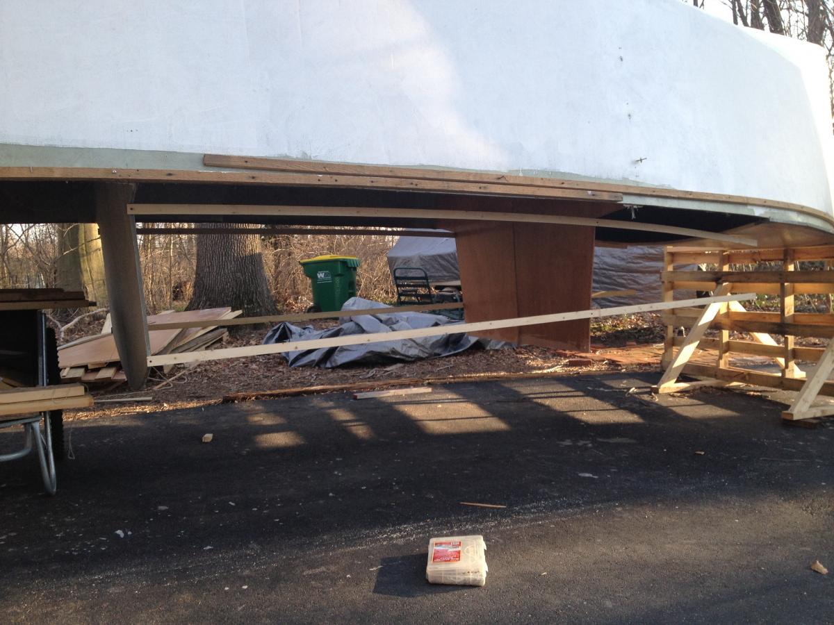

The Princess is a little bigger, and considerably heavier boat.  Looks like I will have at least 10 inches of board buried in the trunk, and 56 inches maximum dragging under the boat.  Finished out the centerboard will be just shy of two inches thick, including a couple layers of 1708.  This board and trunk are plenty strong.  Perhaps the drawings don't do it justice, I had to see this with my eyes to really appreciate the beefy here.

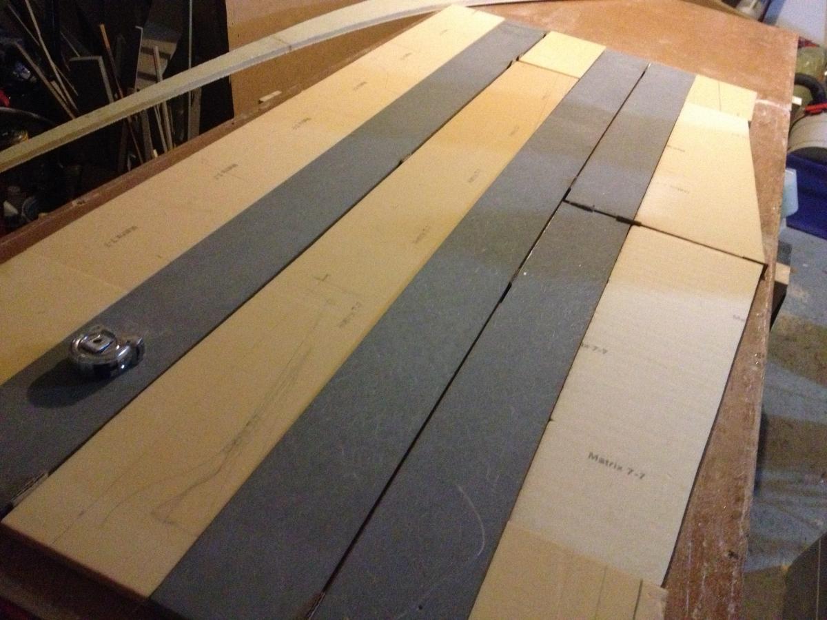

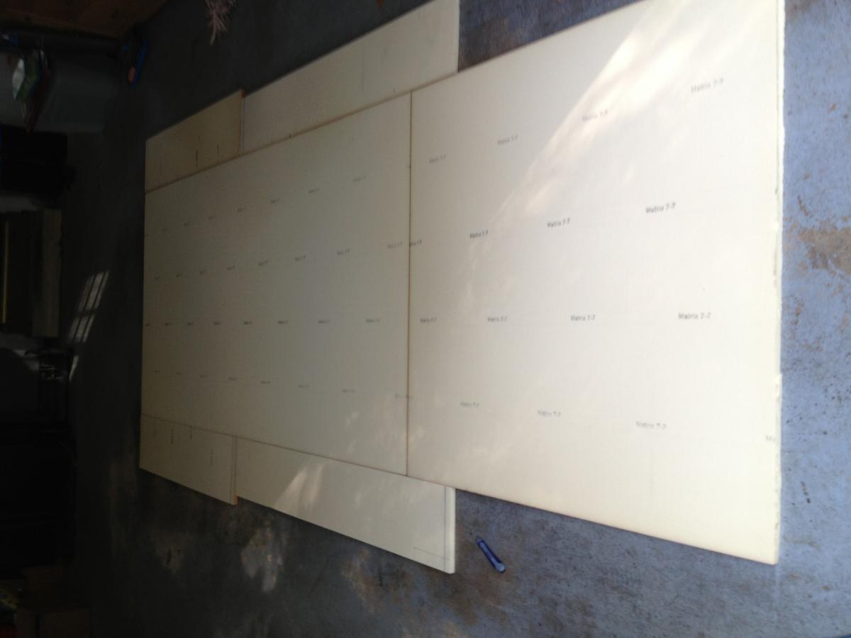

Then laid out the cabin sides on a lamination foam panel
Then installed onto the boat.  There is some trimming to do to get the final shape, but her profile is coming together.post-60-0-43726200-1365644869_thumb.jpg

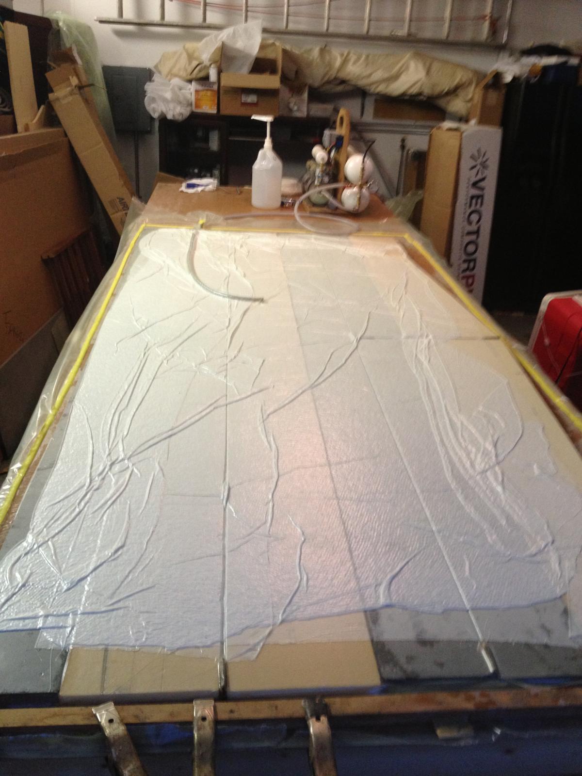

Then it was layout the side deck panels for lamination
They are vacuum bagging now

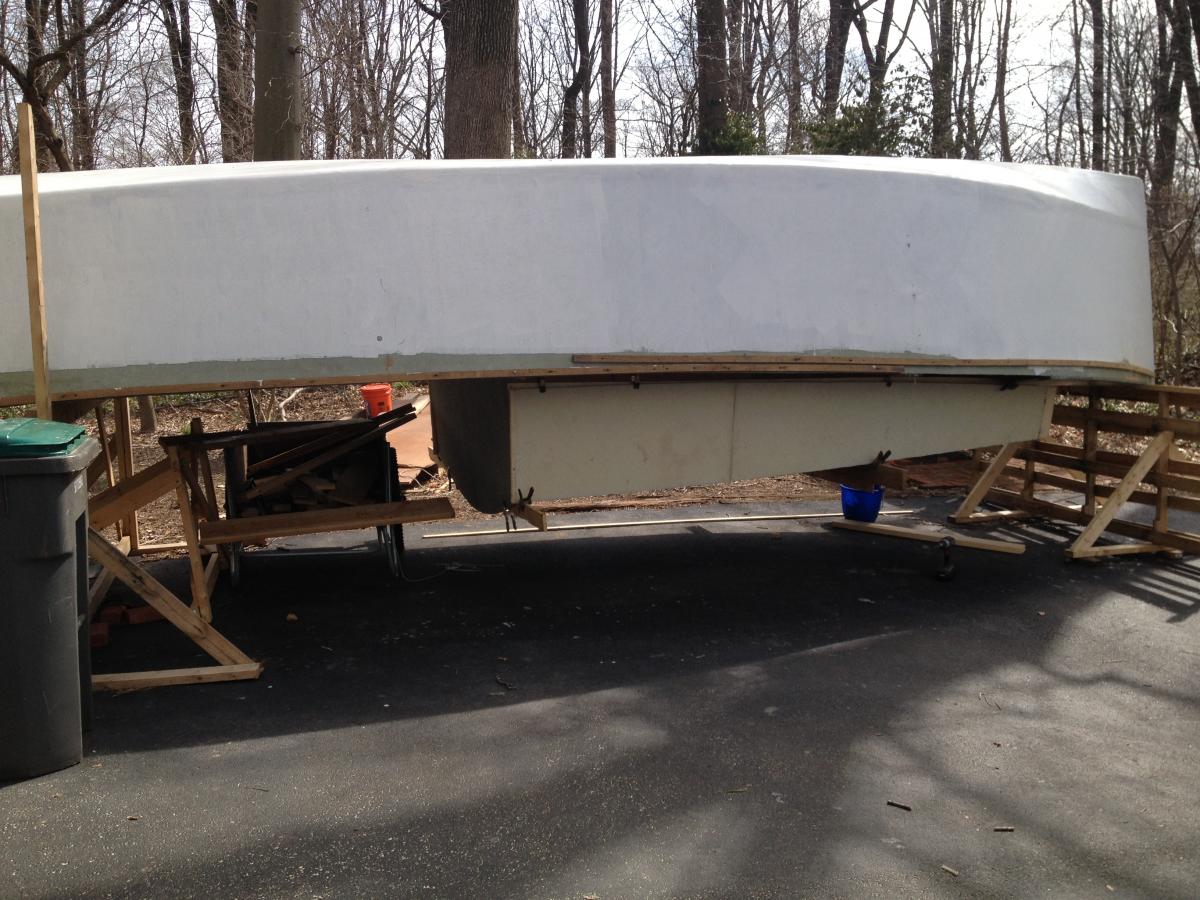

Here is a quick update.

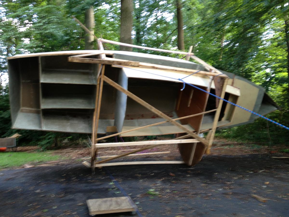

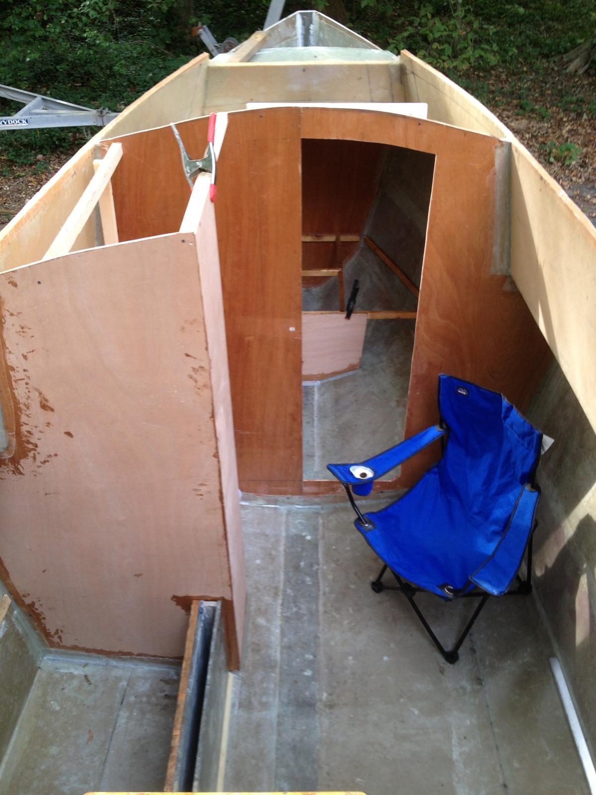

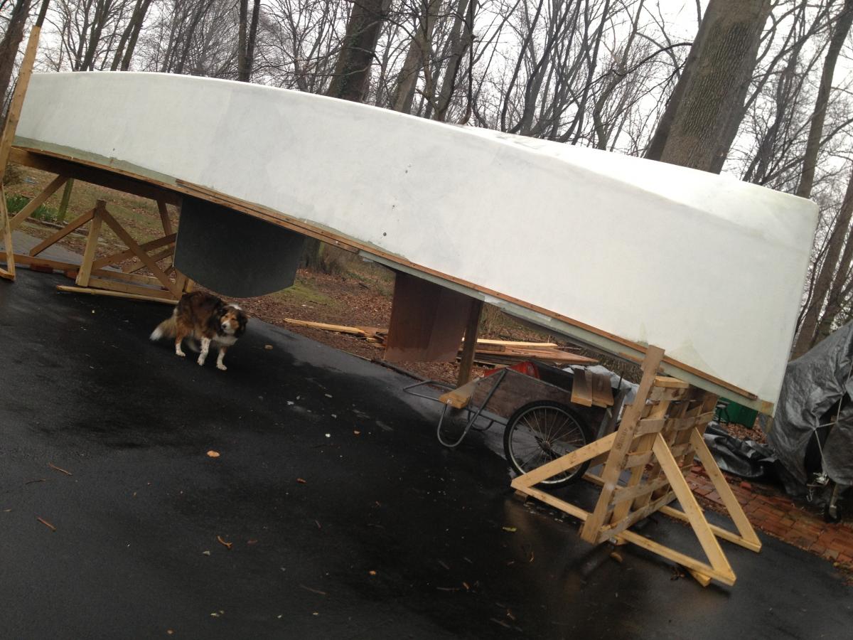

The boat was rolled to right side up in July.  Since then the interior glassing has been completed.  The centerboard trunk, head bulkheads, and seat framing are all now in place.  The head was moved to port to provide a large versatile open space on starboard.  There will be no bench in the saloon on starboard, only open sole.  The folding chair shown there in the picture will be part of the boat furnishings, stowed in its own special place and deployed when comfortable seating is needed.
The cockpit seats are in and the lockers built.  The cockpit seats are angled, with the inboard edge 2" higher than the outboard side.   Port side has a propane locker and a large locker.  Starboard has a very large single locker.    Still deciding details for the aft end of the cockpit area just ahead of the transom.  Motor will be mounted on the starboard transom.

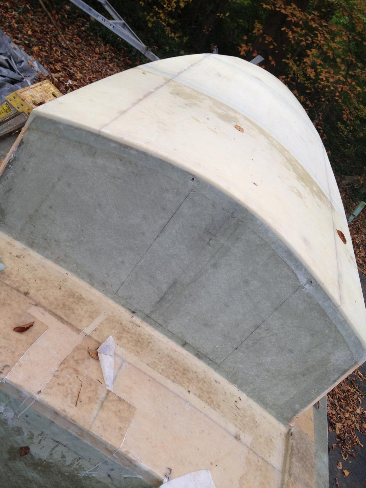

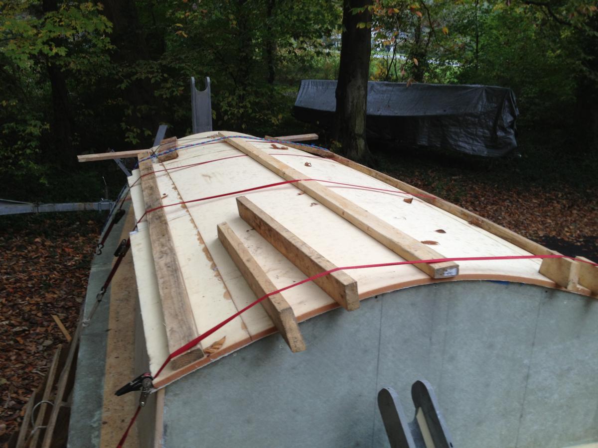

Here the cabin roof foam is laid out for glue up and glassed on what will be the interior sidepost-60-0-50125800-1383879353_thumb.jpg
The laminated foam is epoxied in place after careful dry fitting.The foam bends with a little coaxing.  Care is required to bend slowly and gently to keep all fair and avoid cracking any panel.Note the proposed layout of the companionway to be cut later.  post-60-0-64924200-1383879396_thumb.jpg
The exterior of the foam is then glassed. The foam panels with glass on both sides are incredibly strong.  No additional support beams are required to support the coach roof. The forward section still has the peel ply covering in place giving a slightly different color in the picture.  The peel ply results in a very nice epoxy surface requiring minimal fairing . Dirt from feet crossing the bridge deck was easily removed with a rinse and a little sanding.   post-60-0-85625800-1383881084_thumb.jpg

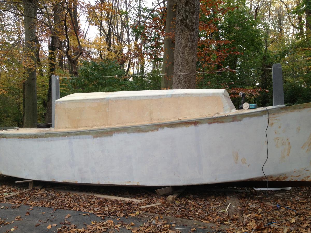

Now the overall profile of the boat is coming out.  The cabin height is carefully tuned to the cockpit seat height providing just enough clearance to see over the cabin from the helm, while giving maximum head room below decks.  The string run between the temporarily placed tabernacles shows the lay of the masts when in the folded position. post-60-0-31106600-1383879412_thumb.jpg
All the exterior glass work is complete except for some details in the cockpit and the tabernacles.  Fairing of the deck and house is underway.  I may get a coat of primer on before deep winter arrives.
  • 9 months later...
Got the paint on.  That is Interlux Perfection in Platimum color.
Shes got 6' plus head room and weighs somewhere around 2200 lbs.  The double layers of 17-08 on the outside with a single layer on the inside over foam core is very strong.  The composite tabernacles came out incredibly strong.  The keel is hollow, and gives a home for the bilge pump.  Pouring the lead keel went well with some help from a good friend.
