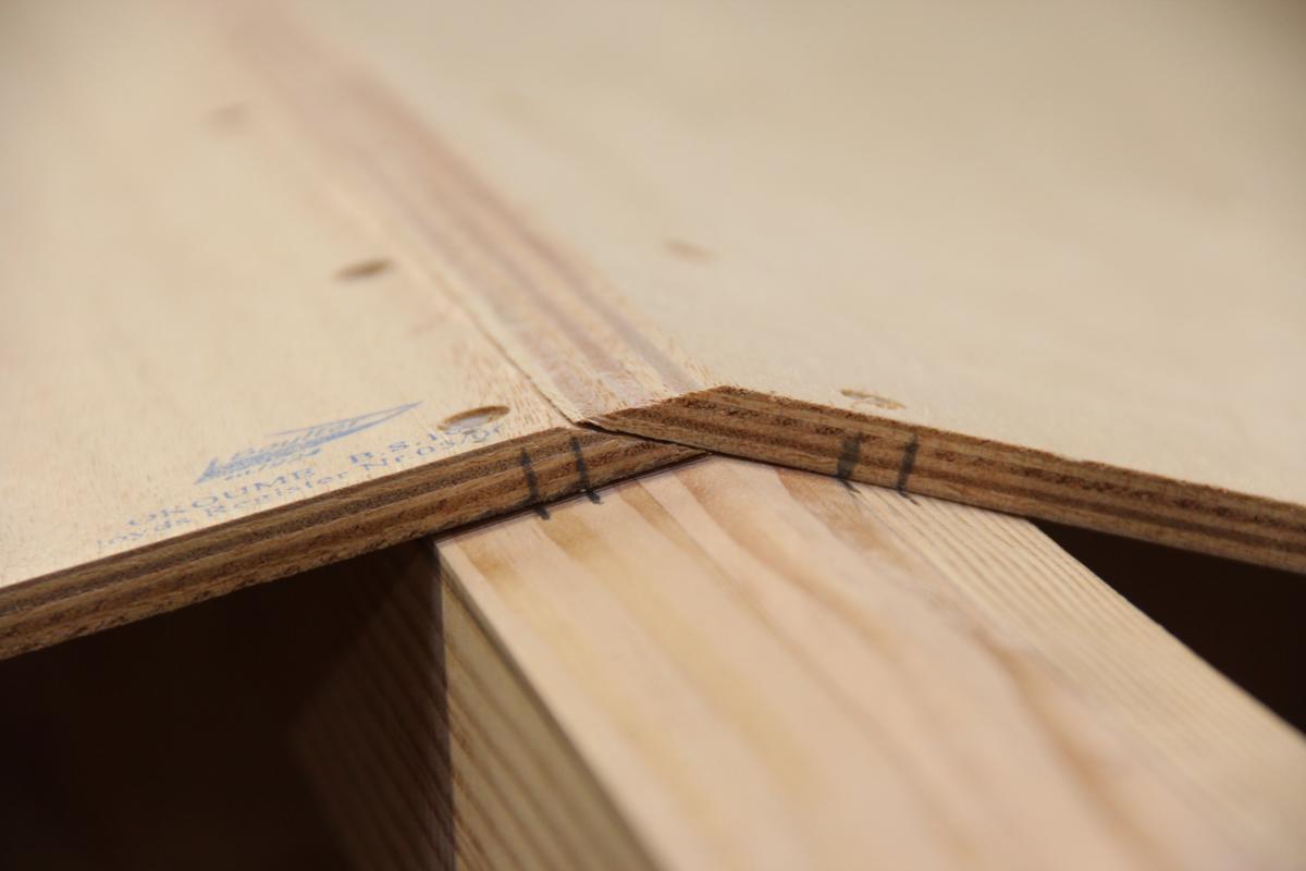

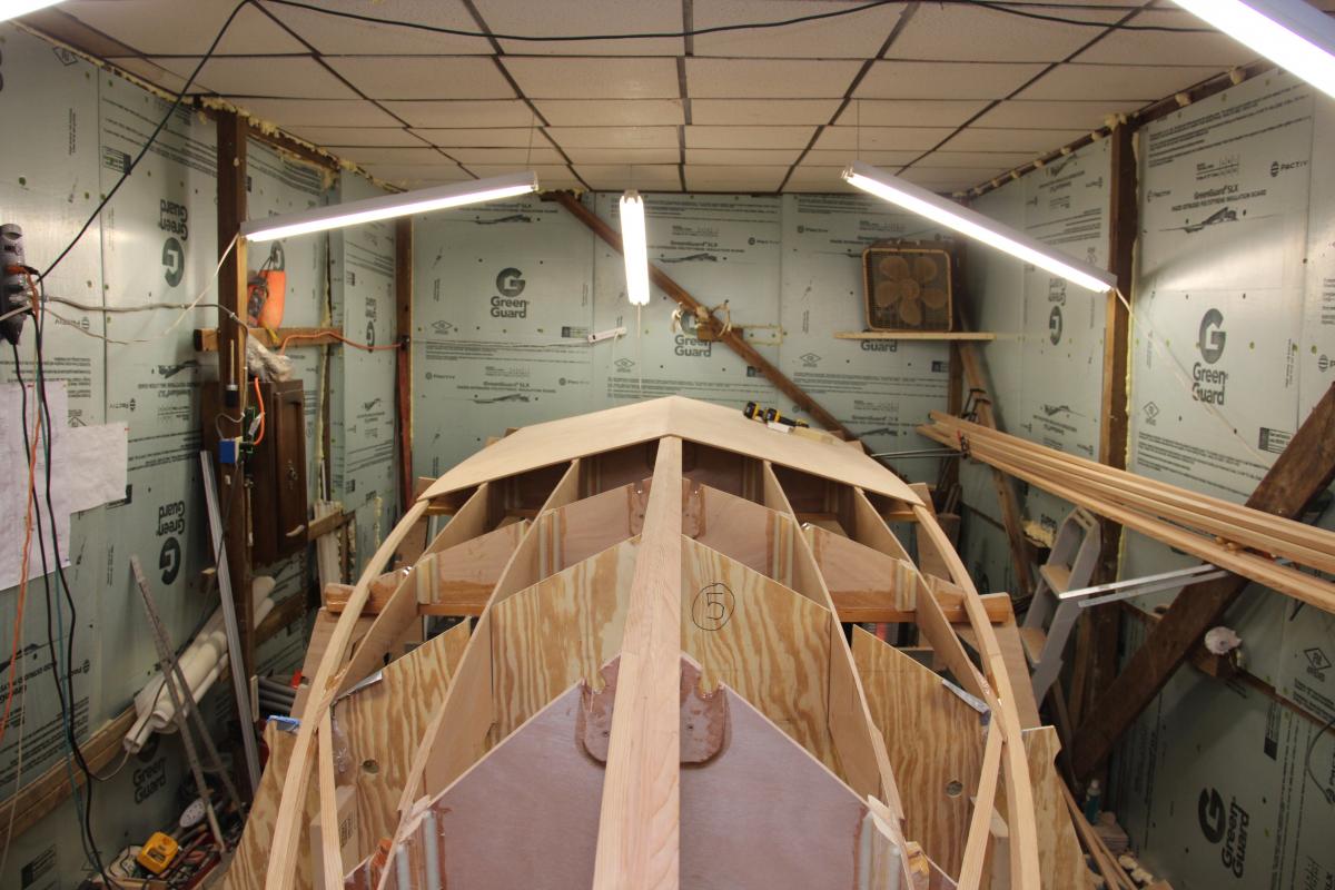

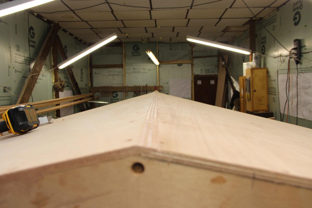

Miyot Posted February 27, 2013 Author Report Share Posted February 27, 2013 Planking. Overlapping bottom planks. Had some trouble fitting planks at the bow. Discovered I had developed a slight crown on my bevels on the stem. Took some time to get them really flat, but this solved my problem. My plank batten was a little soft and was forming around the slight crown with out difficulty. Bending in the full sized plywood was a little different. The planks are now fitting much better at the bow and I feel better. Here are some pics. Quote Link to comment Share on other sites More sharing options...
