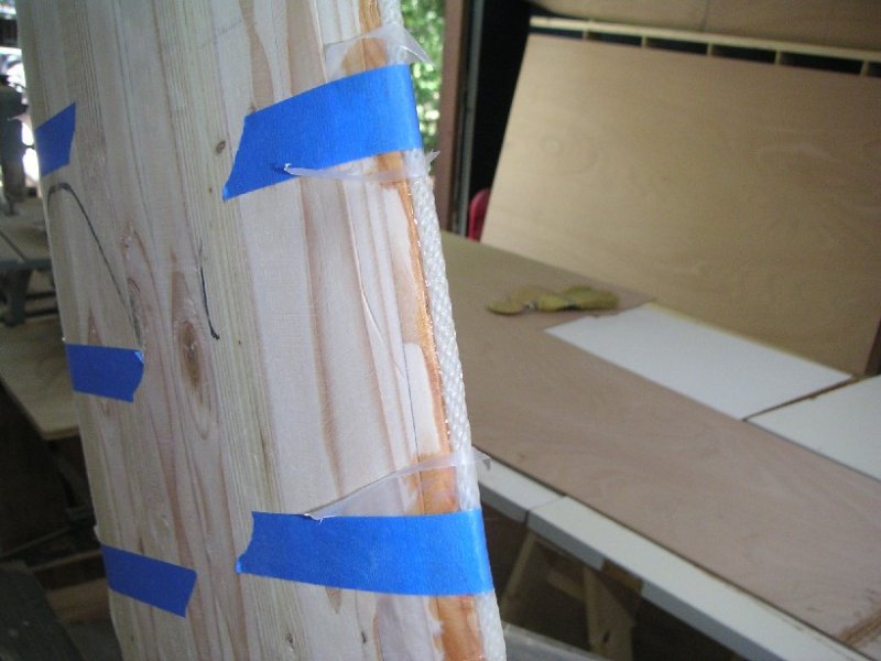

Randy, Some years ago I started to reinforcing the leading edge of my boards with epoxy soaked Nylon or Dacron line.  It makes an essentially indestructable edge that will survive just about anything with no more than a scratch.  Instructions are on the forum somewhere.  Maybe someone can point you to it.
Beefing up the outer edge of a canoe paddle with epoxy soaked nylon line does make the paddle semi-rock proof, as one can use the paddle to shove off various obstacles without splintering it. Should work on centerboards and rudders as well.
I put an epoxy-soaked polyprop line on the edge of both my centerboard and rudder blade.  Details are at:  http://www.svbluepeter.com/lapwing3.htm

I like the epoxy soaked nylon rope idea and will look at using that on the end of the board.
