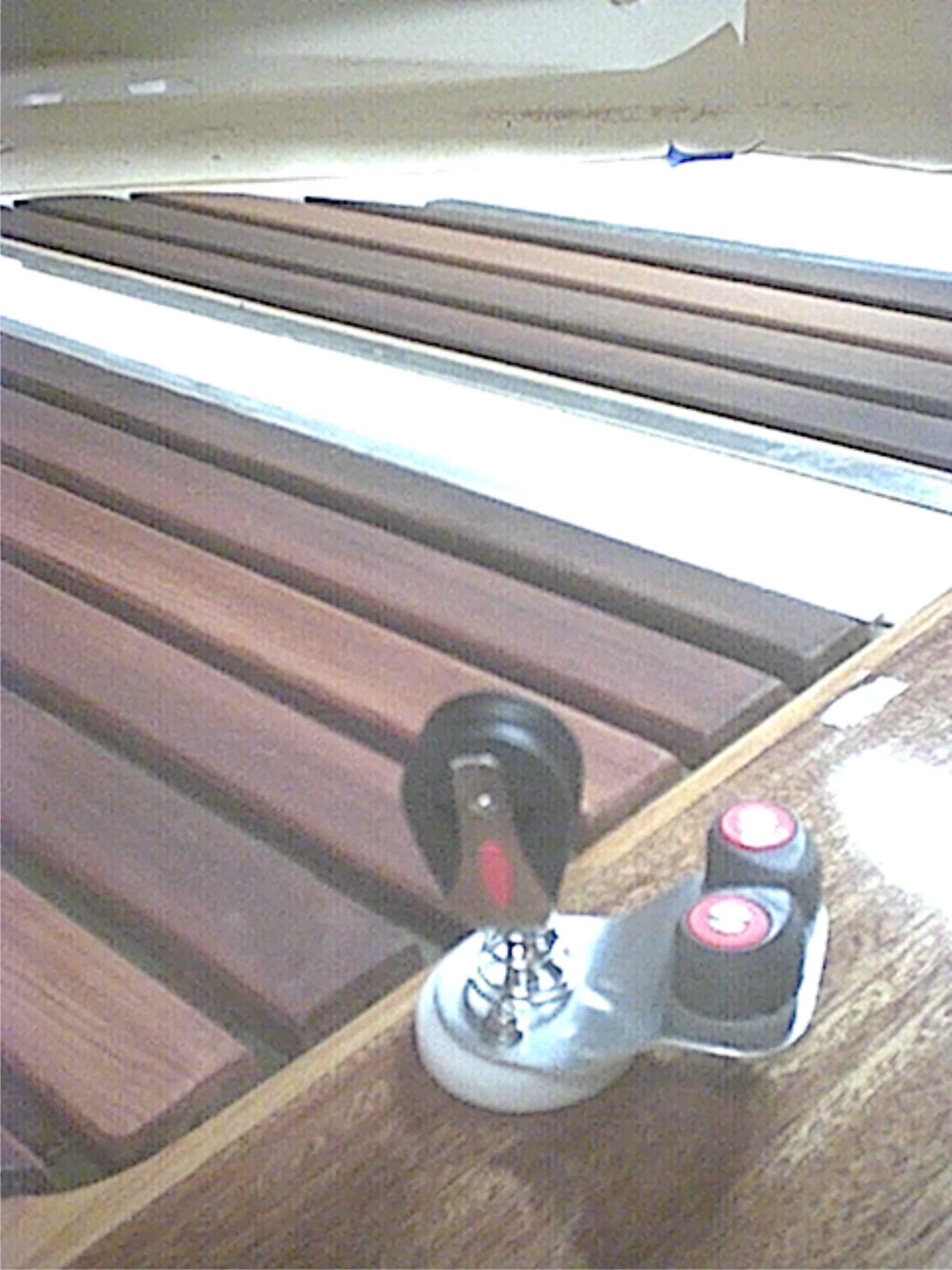

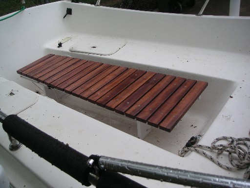

Seat mounted cleats will work, but I used aluminum angle mounted to the cedar slats instead. The first two images are from a really poor camera, but the idea should be apparent. These two show the slats in the "up" position, the last image shows the slats removed, but they normally stow directly on the bottom planks. This a CS-17 with a slightly modified interior and centerboard case arrangement. The area forward of the thwart can all be made one large sleeping space (by raising the slat panels). The modified centerboard eliminates the arm, for wide open tossing and turning while snoozing.

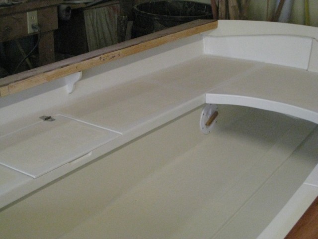

Here's a photo of the cleats on the case and seats.
[attachment=4]

The cedar slats are milled to 3/4" thick and are about 2 1/4" wide (going from memory now). Under the slats are several athwart pieces of 1 1/2" wide, 3/8" plywood, on about 12" centers. These are screwed to the bottom of each slat. The slats are oiled only (tung). Yes, they rest on the bottom planking as floorboards. I used vertical grain cedar for appearance, dimensional stability, light weight and good traction. They are spaced with a 3/8" gap and all edges are fairly heavily radiused.
Since the deadrise in the forward cockpit area is substantial, the floor boards need to be wider when in the lowered position, then when used as a berthboard. This permitted the use of angle stock and the distance from the seat edge to centerboard case is smaller then the angled distance from seat box bottom to centerboard case. This is partly because I placed the seat box stringer on the outside of the box to provide a toe/hand hold, clean up the inside of the boxes and add an architectural detail. I to had to notch the forward floorboards for the centerboard pivot and mizzen step, but because of changes to the case and board tackle, I didn't have any tackle low, on the side of the case.
The big aft cockpit has the exact treatment, but it's attached with 6 big, but short screws. I went to a lot of trouble lining up the aft compartment slats with the forward units so they looked like they belonged there. These slats are naturally much longer and run the full length of the cockpit, which also doesn't have the aft bulkhead seating box. There is a removable seat (as shown), but the slats run under it to the transom.

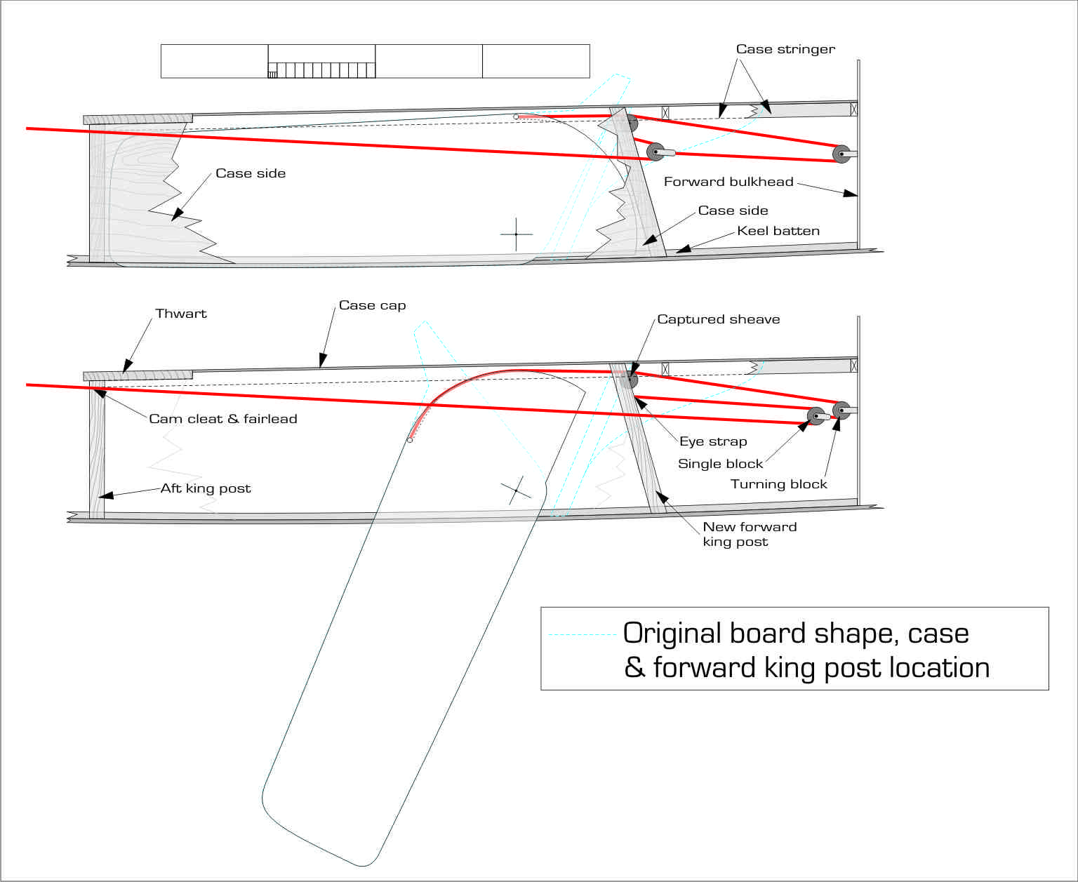

I just modified my CB downhaul to get rid of all the rigging alongside the trunk. Now I run a single line from the head of the CB, down through a block, straight aft to an "Autorelease Clamcleat" (model CL257) on the thwart. It significantly reduces the clutter alongside the case, and works better too since I can force the board down easily by pulling on the line (on the old setup, the bungee was too stretchy, so I always had to reach ahead and grab the line further up, which was inconvenient).
The starboard (right) side of the case used to have the elaborate bungee mechanism for the downhaul, but as you can see, it is now just a single clean line on the port side of the CB case, next to the uphaul. Very handy. The main reason I made the change was to clear space for a berth expander panel on the starboard side footwell, but I would've made this change anyway (even if I don't end up making a berth panel) because it is much simpler and works well. On its lowest setting, the clamcleat releases at about 30 - 50 lbs. of force, making it ideal for holding down the CB but allowing the kick-up function if you forget to release the board.

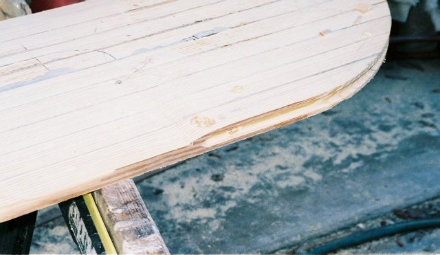

I made my case and hoisting changes from the start, which made a substantial difference in many of the build elements. For example the seat tops and the case cap are the same height. As you can see the case top is smooth and flush. The cases sides were reshaped to permit a different shaped board. The forward end of the board has part of a circle profile. This permits the curved edge to remain in contact with the top of the case, where the stringers live. This was an important strength consideration, because without the arm, the strength comes from the top of the board bearing against these stringer areas.. You could retro fit this feature on a stock board and case, but it wouldn't be as strong.
The board was weighted with about 18 pounds of lead. It drops very well and still kicks up when necessary.
The simple tackle isn't visible in the picture, as it was installed yet, but in reality, the only part you see is the tail and cam cleat under the thwart at the centerline. The hoisting lanyard (tackle) hides under the case stringer and passes between the mast and the case to a cleat mounted under the thwart. Everything else is under the forward portion of the seat (see drawing). The forward king post is also vertical rather then canted aft as shown in the drawing and the hoisting lanyard comes out of the case in a straight run to a single block mounted on the forward bulkhead, not angled down as shown. I did this to eliminate the king post mounted sheave. I used a piece of HDPE in the lanyard exit hole instead.
I've thought about such a cb mod, partly to free up space in the cabin, partly because my cb case spits a fair amount at speed.  the strength issue hadn't occurred to me, though.  I'm intrigued by the tackle; I'd assumed I'd need to put a an uphaul to the lower end of the board, leaving it dragging in the water.  Paul, have you ever had your tackle foul, slipping between cb and case?
It can't, as it rides in a grove routed into the curved portion of the board (one of the reasons I curve this area) which is too close to the case cap to permit it to jump out. The image is crappy and during the rough shaping of the board stage, but the groove is clearly visible, so is the knot hole for the lanyard.
