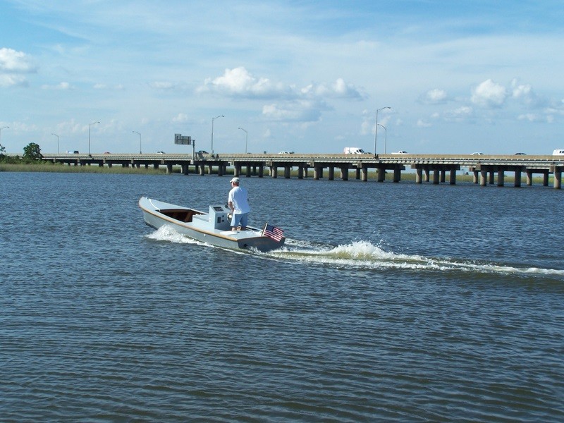

Steve Day Posted September 9, 2010 Author Posted September 9, 2010 Good day today! :grin: :grin: We got her over to the ramp and slid her into the water with no problem. When we started the engine, there was no raw water flow, so we shut down to assess the situation. Seems we could prime the system by closing the sea cock and filling the line to the strainer and raw water came through like it should. If we shut down, the water would flow back out the sea cock. We will add a check valve to the raw water intake and that should solve that problem. A few other minor problems cropped up, but they did not prevent us from running the boat. Operationally, she needs a little bit of weight up front, but passengers will take care of that. While she steered well, we will add a bit to the rudder to increase the length (and area) of the blade to give the rudder a bit more authority. All in all, it was a very successful sea trial and a nice afternoon on the water. A few photos to show her off. Steve Quote
sscoville Posted September 10, 2010 Posted September 10, 2010 Congratulations! She looks great. Are y'all going to install a spray rail, or leave it off? Quote
Oyster Posted September 10, 2010 Posted September 10, 2010 Thats quite a feeling for sure. Congratulations are in order! The trim is another issue though. Whats the statis of fuel, amount, location? stuff like that. Quote
Steve Day Posted September 10, 2010 Author Posted September 10, 2010 In the little bit we ran her, there was no need to have spray rail. We have not, however, encountered any seas or wakes to see how they affect the boat. As we use the boat it will become evident whether we need rails. If so, we will add them. As far as the trim state goes, we were about 1/3 on fuel with one person in her. Fuel is located just under the pilot's seat. There is no weight, other than the hull material, forward of the engine. When Wally and I were both on the boat (with one of us sitting on the foredeck) the trim was better and she seemed to move a little better through the water. We are planning to add coaming around the open deck and bench seating, so that in itself will add some weight forward, but the real weight will be people and/or cargo. There will also be storage under the foredeck and there will be some weight there, such as the anchor. I was initially worried about the trim, but I think we are OK, after thinking about it overnight. Are we having fun yet? Steve Quote
Paul T Posted September 11, 2010 Posted September 11, 2010 Steve: You guys did a super job.. And got her in the water really quickly. I'm sorry I missed the launch but thanks a bunch for the pictures. Congratulations to you and Wally Sincerely: Paul T Quote
redviking Posted September 12, 2010 Posted September 12, 2010 Steve, The photos really do Wally and yourself's hardwork justice. Do you have any performance stats as yet from your short trail? Did the engine perform as expected? You have no doubt inspired a new generation of Rescue Minor builders. Congrats on your success. Eric Quote
