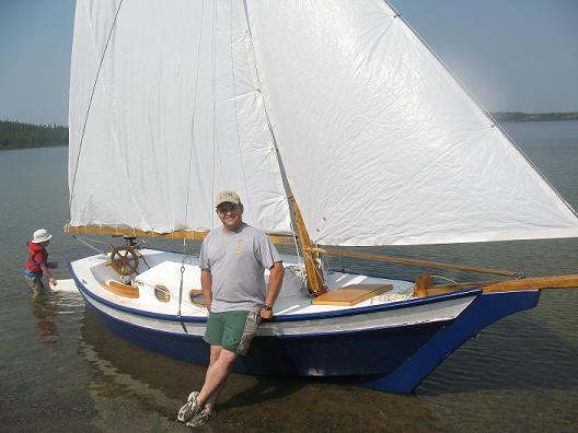

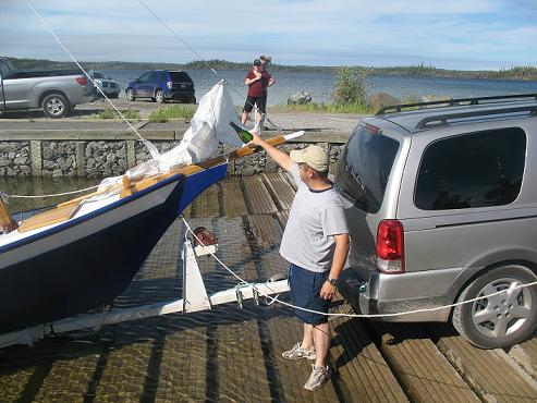

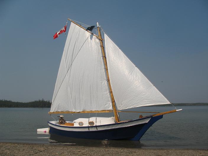

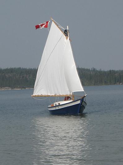

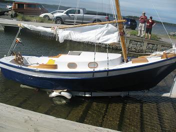

Denis Goyette Posted July 29, 2008 Posted July 29, 2008 Here are some pictures of my 98% completed Weekender being put in the water for the first time. Quote

Greg Luckett Posted July 29, 2008 Posted July 29, 2008 I just looked at the pics again. Those are some great shots. Is she a Vacationer? Quote
Denis Goyette Posted July 29, 2008 Author Posted July 29, 2008 Thanks Greg It is a Weekender, I still have to put the cabin hatch, handrails and splash cuming. The location is Prelude Lake in Northwest Territories The water temperature is about 15 to 18 degree celcius. And Lay off the flag LOL ;D Quote

Craig Posted July 30, 2008 Posted July 30, 2008 Denis, I agree she looks wonderful. Love that blue and white ;D ;D ;D Here is a thought after looking at your main. Remove the lashing from the mast to the outer end of the boom. If you don't have one make an outhaul to tension the sail ( see Franks site for examples) and fly her loose footed. That will restore the shape at the foot and give a bit more power to the rig. Pull the outhaul tension up for strong winds and ease it out for weak. The light winds need a more wing shape to the sail then stronger winds. Plus you'll like the looks of the loose foot more. Quote
