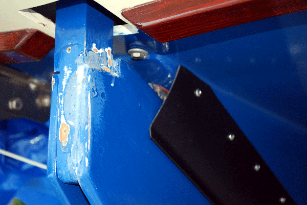

Jeff I think you had a much rougher time of it than I did on the water. That is quite the hole in your boat. I'm glad you and the boat made it back safe. To your question both motors are fine. The gas motor only lost it's handle. At the time I thought the pull rope had broke off and went back into the motor. As for the damage to the rudder box you can see the epoxy patch already in place just a little paint and she is ready to go.
