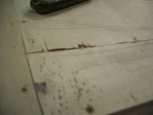

markja Posted March 5, 2008 Author Posted March 5, 2008 I have finished epoxy filleting and applying the fiberglass tape to the inside of the Spindrift. I just flipped it over to work on the outside and discovered a spot where the outer plywood veneer is bubbled. It isn't very large, about 3/4" x 12" across the face grain. back nerar the transom. I have slit it carefully with razor knife and plan to force some epoxy to glue it back down. Since it is so close to the transom maybe a layer of fiberglass cloth to cover the slice in the veneer? How common does this occur? I am using the good stuff--BS1088 Okume. By the way, I read somewhere here that the stitching wires can be removed by heating them with a torch and then pulling them out. It worked great for me. I let the wire cool for a couple minutes first and it pulled right out. I can't seem to insert a picture to show what I am describing. Also, any idea how much paint to purchase for a Spindrift 10? I am thinking of a light color interior and dark color exterior with varnished gunwales only. Thanks again. MARK Quote
Steve Day Posted March 5, 2008 Posted March 5, 2008 That delamination of the Okume plywood is a new one on me. I have never encountered that. I would say you have the right idea, but if it is that large an area, I might think about peeling it back and building up the area with epoxy & fiberglass cloth. In any case, it would not hurt to have a layer of fiberglass cloth and/or tape over that area. As far as paint goes, I used less than a quart of primer and a quart of color coat to cover both the inside and outside of the boat (Spindrift 10N). I finished the seats and the gunwhales in varnish. Maybe the "pros" have another opinion. Steve Quote
