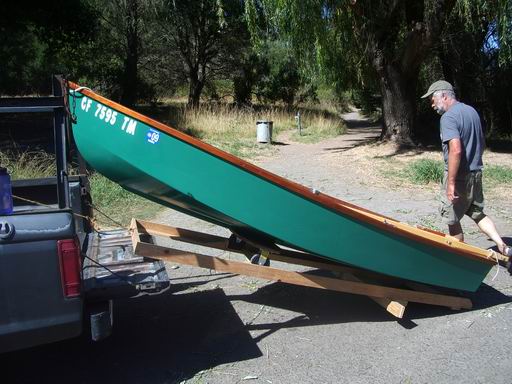

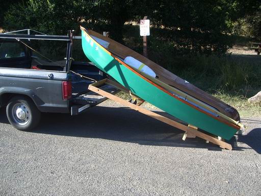

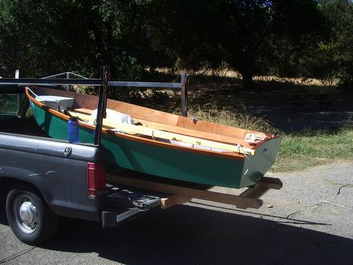

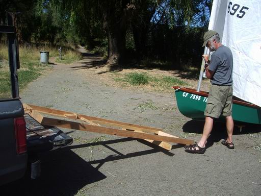

I have finished my Spindrift 10. It is great fun to sail and I have managed to take it out after work on a small lake near our house several times already. My cartop helper person only helped once though, she decided it is too heavy. So after some trial and error (only a few small scratches) I now have this gadget for getting it in and out of the back of the truck fairly easily by myself. The other nice thing is that the boat can stay right-side up on the dolly with all the gear inside. It makes it harder to forget to bring important pieces of gear (like the mast, which I left behind one time). There is a dolly that fits into the daggerboard slot and a ramp to wheel the dolly and boat up and it stays in place with a block of wood on the ramp. Then I lift the whole thing up and slide into the bed of the truck. It sticks out about 4 feet which is manageable and legal. A trailer would be easier, I guess but I haven't figured where to store it. Mark
